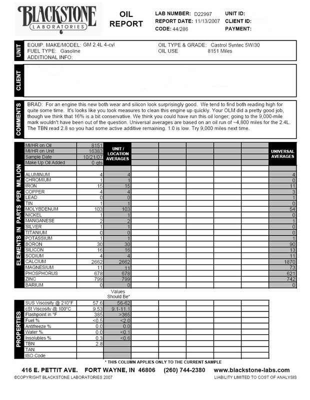

I didn't say the engine lost power, I said it didn't feel right to me when the dino oil went past the 5,500 mile mark.
On my last OCI, I ran just over 8,100 miles on synthetic oil and only changed the oil filter when I put in the new oil.
The only reason I changed the oil was because I am doing 6 month OCI cycles with syntehtic oil and didn't want to be changing oil in the freezing cold.
When I get my UOA report back from Blackstone, I'll post it to show how the oil held up.

Here is the UOA report I said I'd post when I got it.
8151 miles, did not change the oil filter during that entire run. Very good UOA report.

Makes you feel a whole lot more comfortable about the OLI, huh.
And It's better than, "Well I always......." !!!
