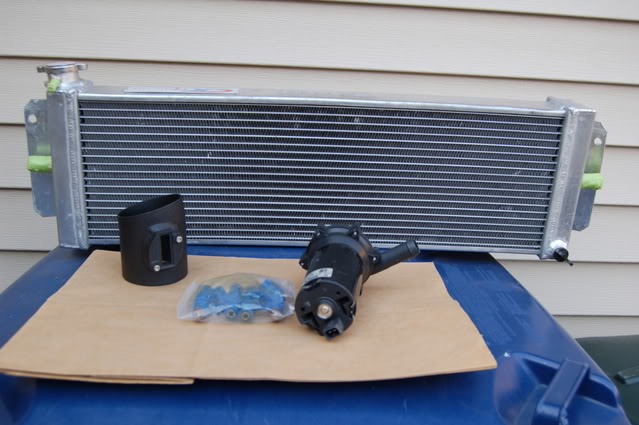

You don't need to do any drilling on the engine. Use 6mm fasteners for the IM and as for the lower IM bracket, drill that out to accept an 8mm fastener. I removed my fascia and drilled holes in my bumper and bolted a piece of 3/16 steel about 3" long by 1 1/2". Then I used the 2 inner tabs on the heat exchanger and fastened them to those brackets. You just have to make sure the HE is in far enough in to clear the fascia. With an SS fascia you may have a bit more room. I removed the outer 2 tabs of the 4 that are on the HE. The mounting of the HE was by far the most frustrating part of the install.

This is the type your gonna want. Fits behind the bumper but under the bumper crash bar. Expect to do some Modifications to fit it in.
