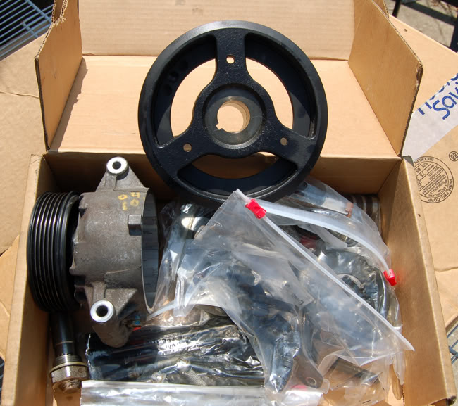

OK Cool Gary.
Sounds like you know what your in for then. Being a ASE Mechanic your way ahead of me on that front.
Either way on the AC, I believe your gonna have to redo your AC charge from what I was told. Swapping out to 6 rib.
Hope the one I got matches mine to make the swap I just got whats shown here. Left side in pic.
Start a seperate thread here and on the Cobalt forum and you'll have a seperate install thread we can all try helping you out if you have any other questions.
And Please take and post Lots of pics along the way.
I'm going to start a thread there once I start mine just so I can share and get Help as needed. Ive done tons of reading and asking but I will ask more questions as I install.
You know about metals reacting to one another I am sure, I see alot of guys just running to home depot for steel bolts in aluminum.
I am trying to use all the GM bolts I can, I want them matching, looking oem stock, and being able to unassemble later if needed.
Good luck with you HHR Supercharger install, like I said before, the more the merrier.

A&P, the Cobalt SS A/C compressor I bought had a Torx screw in the end of it. When you take that screw out you can pull the outer clutch plate right off (you used to need a puller to remove it). There was two washers underneath that set the clutch spacing. There was a snap-ring underneath that holds the pulley on and then one more holding the clutch coil. There would be no need to discharge the system in this case. My '07 has the old style with a nut on the end of a shaft and I will probably need a puller to work on it. I am not sure about the discharge status. FWIW

Gary I dealt specifically with this. I broke that torx bolt off trying to loosen it thinking I could just swap pulleys. GM uses a thread locker on that bolt and it does not want to back off without heat. It would be easiest to swap the pulleys by simply swapping compressors and recharging the system. They do interchange. Its just hard to work in that pace to get a good angle at that bolt. If you get that bolt off on the car props to you! No puller is needed to get the pulley off, but the spacing with the washers is important for the clutch engagement. The lock ring is all that holds the pulley in place.
