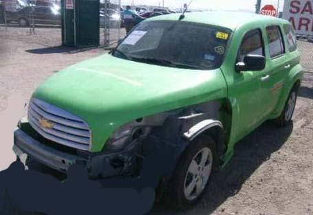

Just a quick look at what is under the sheetmetal reveals wide spread uglyness. I'm not saying it can't be done, but I like them with the fenders in place.

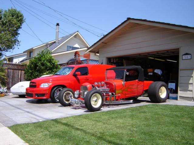

You could go to all of that trouble and misery ,or, go out to the garage and "WAALLLATT" just have one appear. Granted it's not a coupe but, that's my next project ( I have the coupe body) to put the body on that you desire!!

Are those wires on the rear too? What a machine. Nice line up. :-) God Bless, Marc

Tell us more. Small block, looks like a Moon tank up front, cut down '32 shell? Looks like someone did a lot of work. :-) God Bless, Marc

I built the car from the frame up, three times actually and still want to change it, what's wrong with me? Yeah- wires all round. Had to split the rim and add a center section to get the rear to 15"but, that was back in the day when big tires were cool.It's a small block-70'vette. comp cam, world headsw/roller rockers(Crane golds)Vertex mag,Offy manifoldw/3/2'sby Automotion(very nice and expensive). Also Halibrand quickchange and B&M 350 auto/manual.The "Moon" tank is a puke tank for the "Ron Davis" custom aluminum radiator.And yeah the radiator shell is a sectioned 32'.At one time I used to show this car but, old age has caught up with car and owner.If anyone wants to know I'll try and tell you more.

I did catch those three two's. :-) What a machine. Three rebuilds = a true rod man. :-) God Bless, Marc
