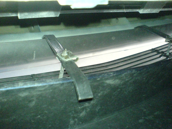

Hey J you said the bottom grill was a snap to install - is it suppose to come with brackets or something? I still have my bottom grill sitting in my garage as I have no idea where it fastens to

mine came with two c clips i think is what they called them.. The screw wen thru them then into the grill and those c clips went from the upper lip to the lower lip behind the bumper.. I will try to take a picture tomorrow if you want me to

That would be awesome if you could - then I could get some thing fabricated. Much appreciated!

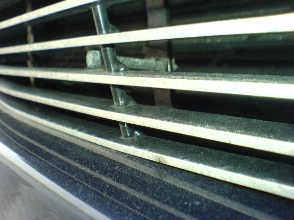

Heres pics of mine.
And thanks very much for asking, I found while I was taking the pic that it had loosened to the point where it was rattling around.
Checked my upper grille too, sure enough one of the top shafts had turned loose and luckily was still sitting on the rad support. Another of the top nuts was gone. They were last checked before winter.
I advise locktite or getting proper locknuts.

I dont need to take pics now.. That exactly what mine looks like. I ment to check the nuts and such today and I hadnt thought about locktite on everything..

Hey thanks a lot guys for your time and pics... I guess it worked out for everyones benefit
