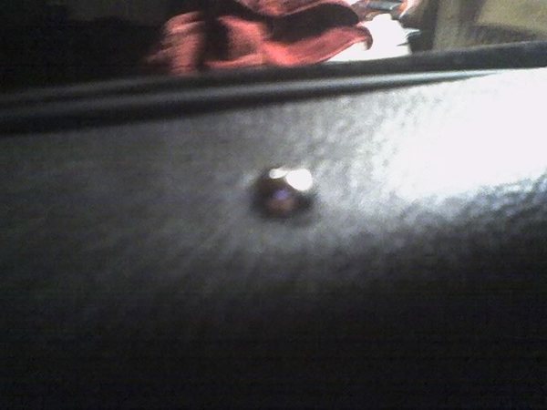

Old Aug 8, 2008 | 09:51 PM
  #29
chevyorange's Avatar
Joined: 06-09-2008
Posts: 354
From: Seattle, WA
Here's what my driver's side lock looks like down:
