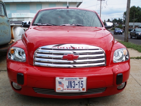

Posts: 40,083
From post #4 here’s the rear red bow tie off Bob
He sent it to me after Bob was totaled
Makes it easy to find my HHR in the snow!
OEM bow ties are expensive on EBay and sometimes misrepresented. Double check the part numbers before you order.
