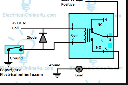

What? Do you know what a relay is for?
Wiring is like this:
+12--------Device---------switch--------ground
To wire a relay in put it in place of the switch and actuate it similarly.

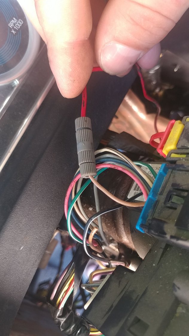

Alright I figured it out.
I wired the 12v relay as normal, but with the change in the trigger and ground wires.
Ground will now be the wire coming from the horn wire at the steering wheel, since it only grounds when the steering wheel button is pressed. I cut the wire leading from the engine bay so it would not get 12v. The wire leading into the harness is the side you will tap into. It might work without cutting the wire. But there is enough room to re-attach the wire, and I've installed breathalizer units in vehicles and cut factory ignition wires and tapped into them and then removed units with no issues, so I feel confident in this.
Your car might be different, so I suggest using a power probe if you can get your hands on one, just to be sure. (The power probe is probably my most useful tool for 12v)
12v trigger post on the relay will be bridged with the 12v+ input wire. (Which you should fuse)
12v output stays the same.
Here I demonstrate how the lock alarm still works with a $5 alarm siren swapped for the stock horn, and the horn button works with my added air horn.

A relay doesn't care what polarity triggers it. Most DC circuits are switched on the ground side to avoid arcing.
Evidently, you don't have a good grasp on DC electronics.
There should be either an internal or added diode on the relay
