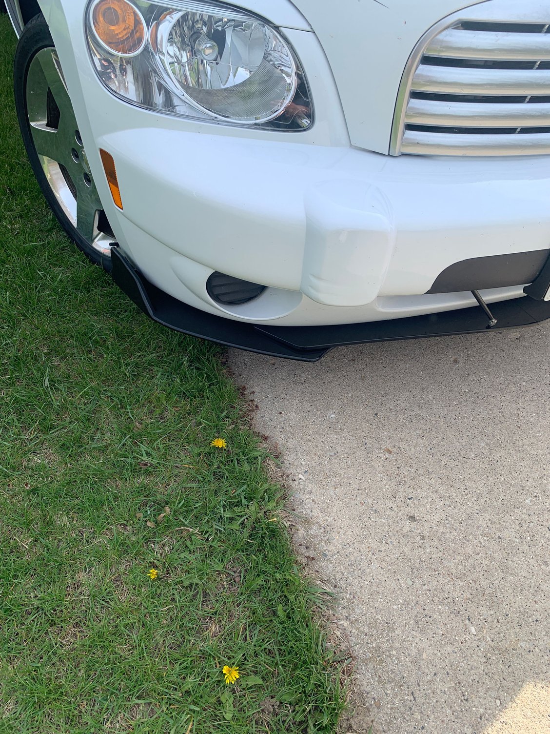

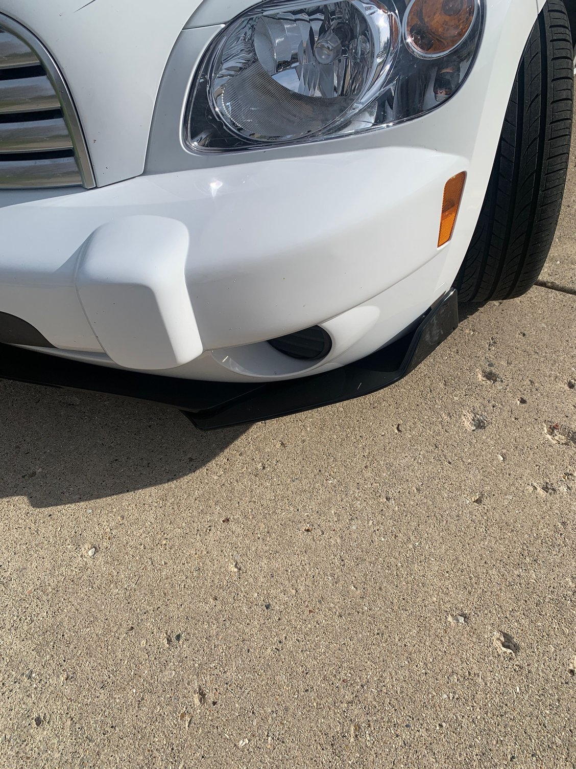

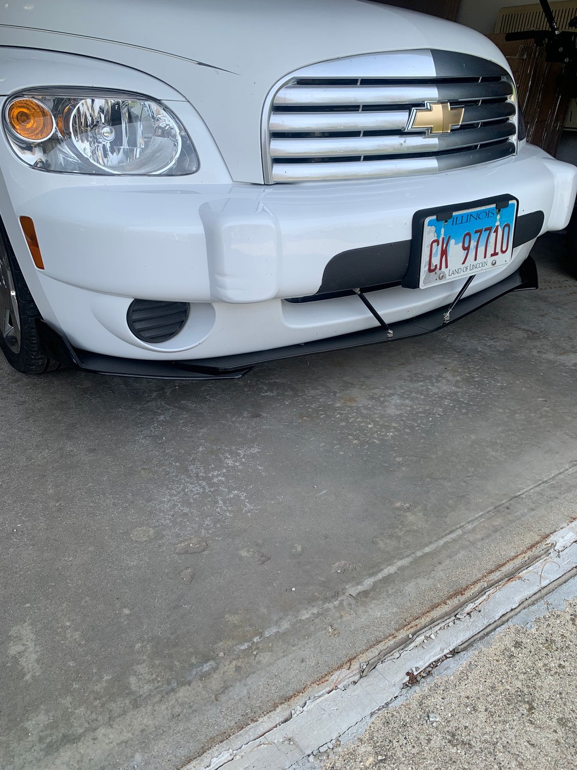

I bought a cheap front bumper splitter form ebay. Its plastic, comes with hardware for mounting and 2 adjustable links for leveling and stiffness. You can search HHr splitter on ebay. I paid $39. My lower plastic air dam was already broken off so it made installation easier. The supplied self tapping screws are good for temporary mounting to make sure you have it postioned where you want it , but I installed 1/4-20 nuts and bolts for permanent mounting. Overall I am pretty pleased with it for the price. Took about an hour to install. I did find a couple of youtube videos installing this same kit on other types of cars.

A nice replacement for the OEM version, spoiler? Or air dam?

Just be careful with the center support rod. You don't want to be disqualified like 43 was.

My oem one was half broken off when I bought the car. So I went with this.
