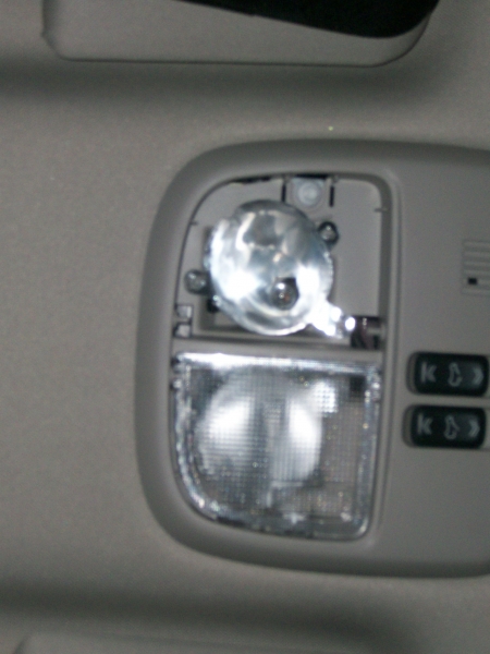

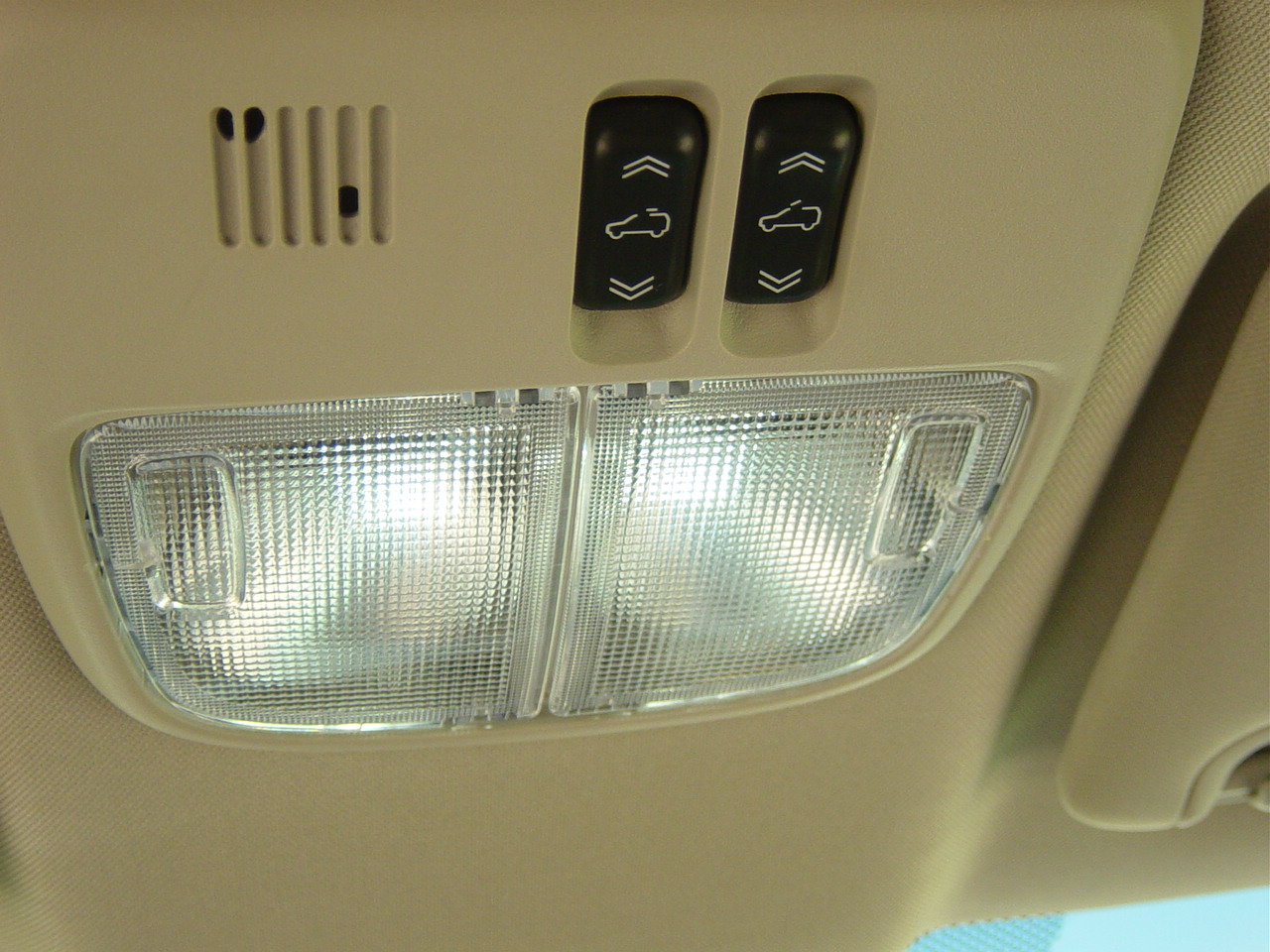

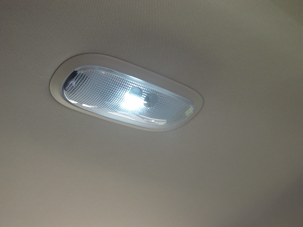

A few quick pics: I like the way they look, but being me, I just ordered the high powered superbright versions of these today ...
Rear cargo light, dome, and passenger's map light lit up:
The dreaded overhead console! You can see the OE bulb's behind the reflector; once that reflector's CAREFULLY removed the bulb comes out only one way, up into the headliner- doable, but not easy (at least for me)...
Taken from the driver's seat:
Passenger map light-
Passenger map light, dome light + rear cargo light lit up-

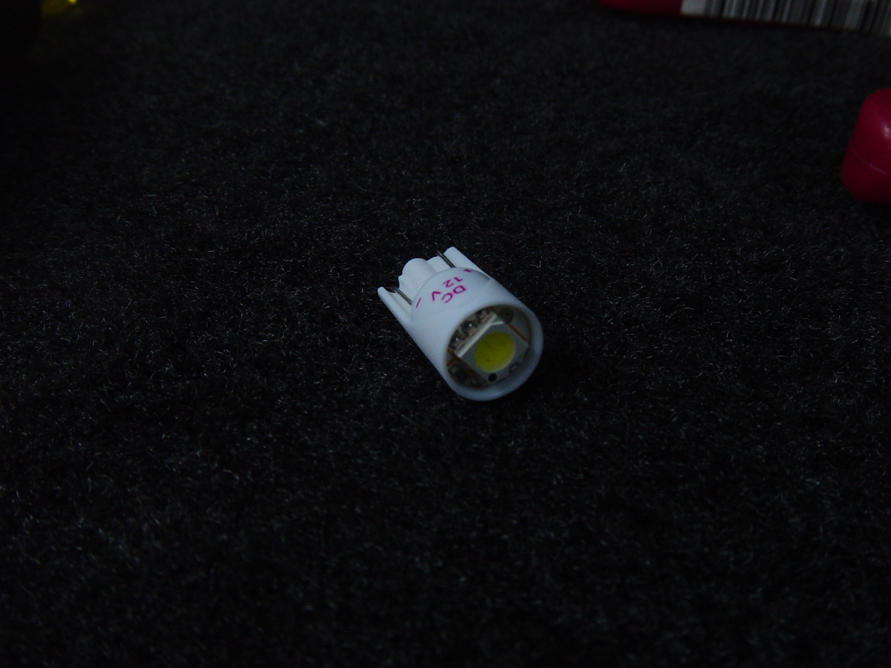

At least for the 2010... all your interior lights can use the 194 wedge style bulbs.
I used these in cool white. Nice crisp color and light.
WLED-xHP
http://www.superbrightleds.com/cgi-b...2FWLED-xHP.htm

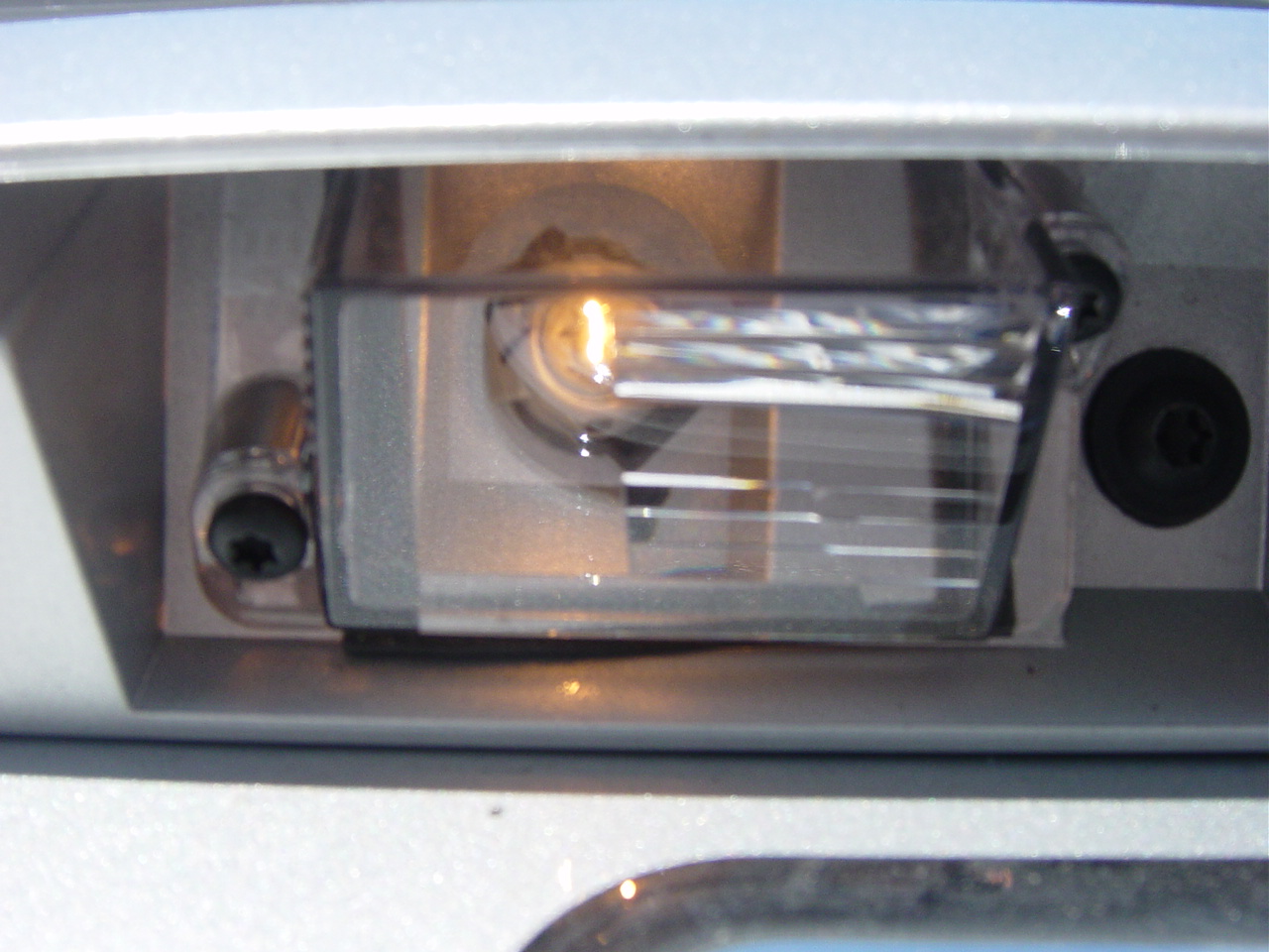

Which also happens to be the same bulb I used in the plate lights
Stock
LED

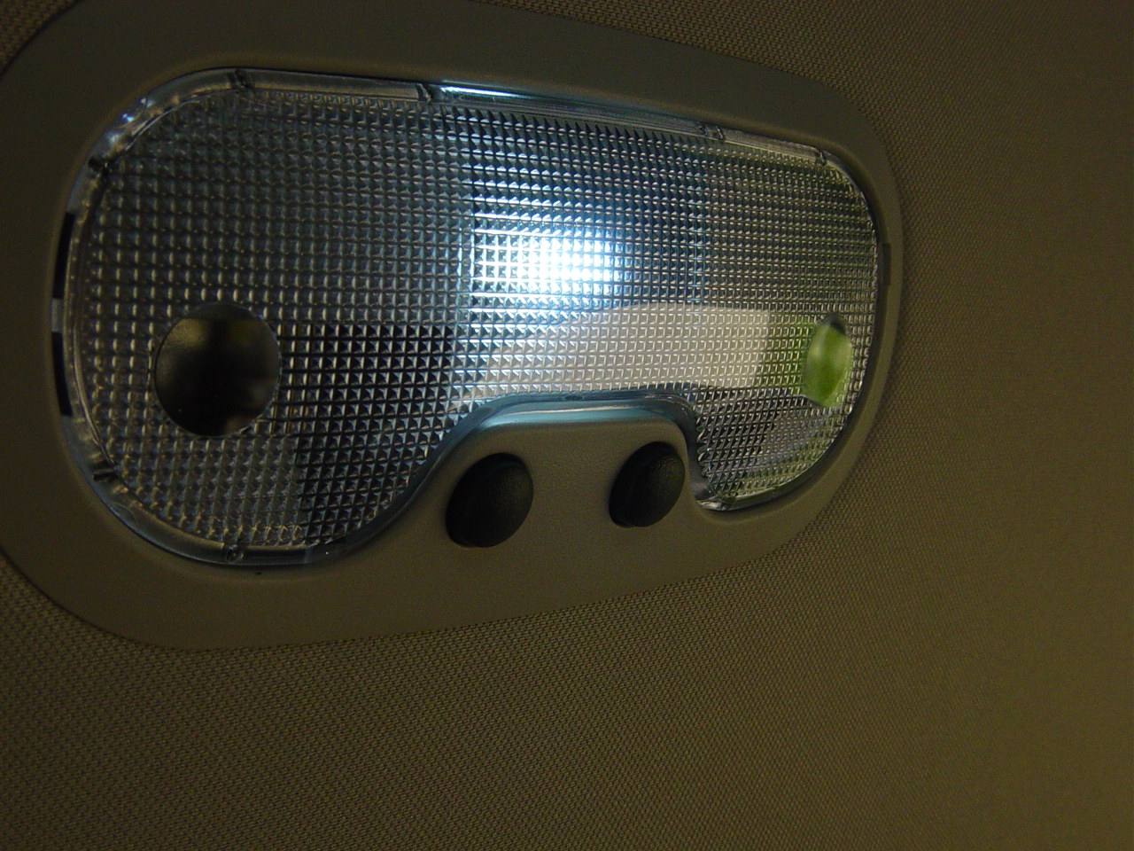

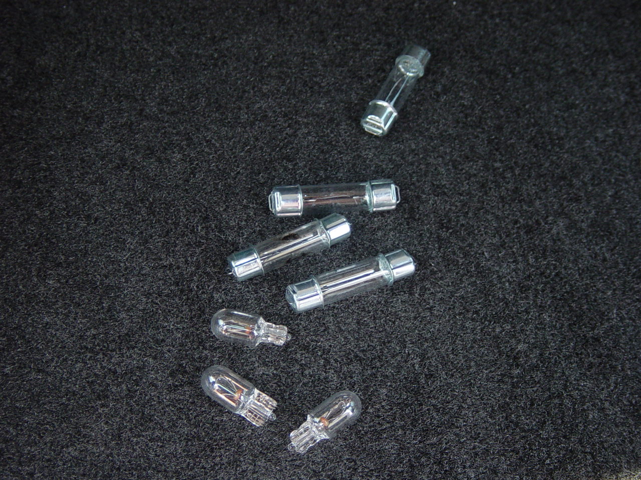

For the dome lights in the back that are tubes. They are a simple 4410 bulb. I used their 4410-x9 Again in the cool white color
http://www.superbrightleds.com/cgi-b...on_4410-x9.htm
out with the old

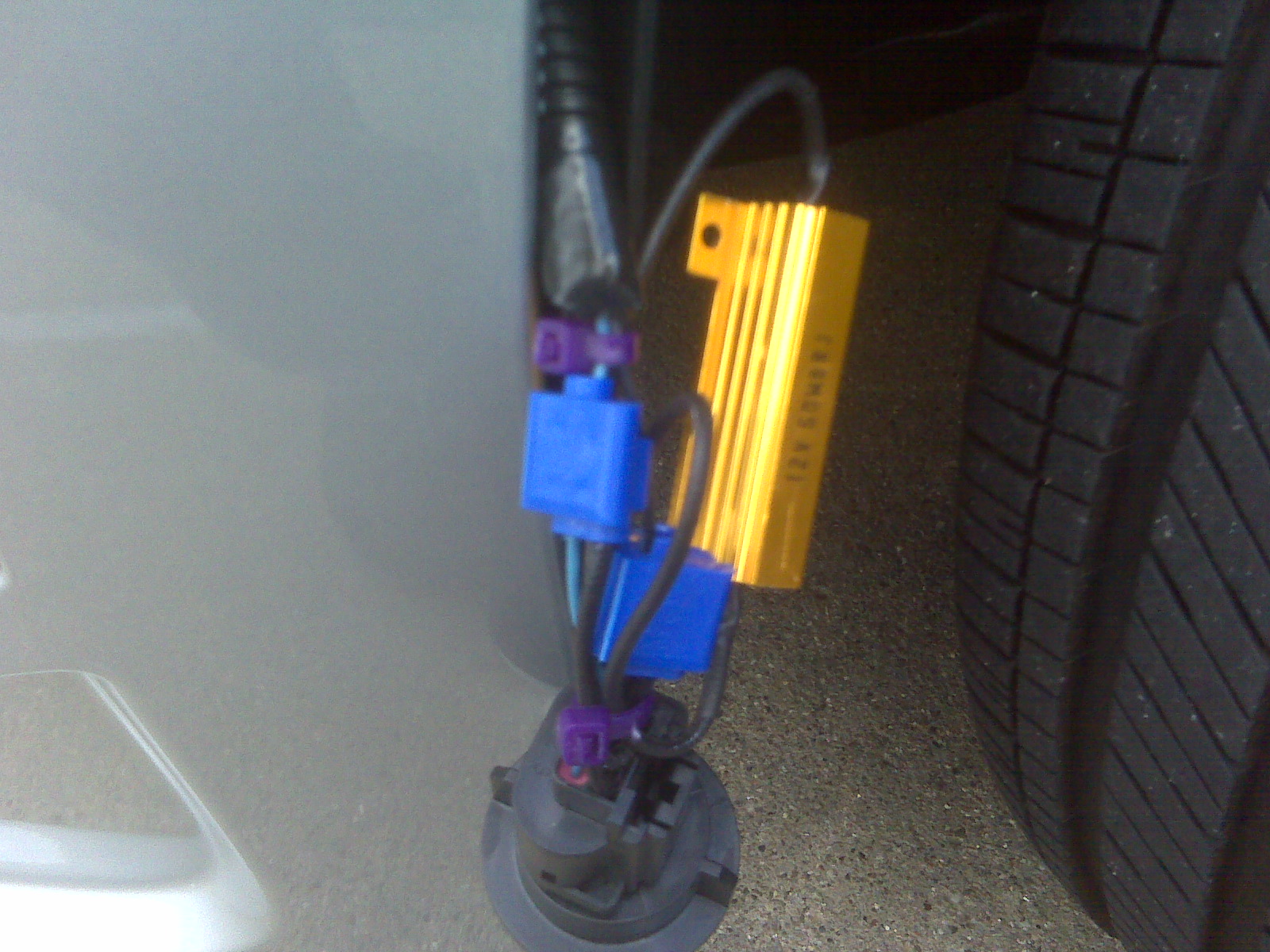

However you will also need the small resister to install on one of the light wires... if not, they will continue to glow when the lights are "off". This is due to a stray 6 volts in the system, caused by the dimmer switch in the dash. It's not enough power to light a standard bulb but these LEDs are power hungry and will light up with very little power. The one you need is for marker lights RL-2525. You only need one to fix the dome lights.

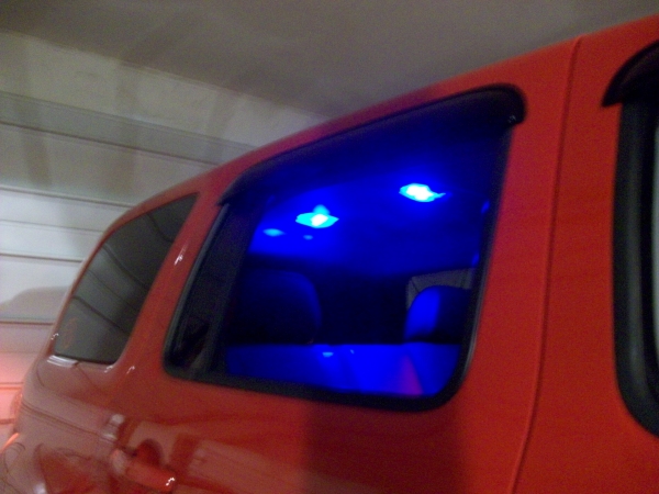

AH-HA - That is why mine all have a small glow to them at night when I'm driving. I installed red T-10 led's in the 2 front map lights and red tube style led's (can't remember the #) in the 2 rear cargo lights. Can you just install the resistor by sliding the ends into the slot with the light or do I have to remove the dimmer switch and install it inline with one of the wires?

The tubes are 4410s. You can see the old ones in the pic above.

With the resisters, they just install "in-line" with the splicers (that I normally don't like but this isn't a bad use of them). Here's a pic of the one installed on my front markers. After I put them in I got the hyper flash and that was super annoying.
The one used on the dome light as I said earlier, is smaller but installs the same. I installed mine on the cargo area dome light, double side taped it to the roof so it wouldn't sit on the interior liner. Reason being they get hot, and you don't want it to burn the liner. I checked on it a week later and it was still fine.

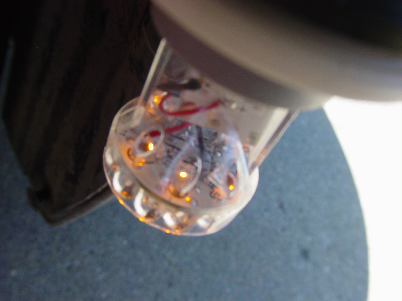

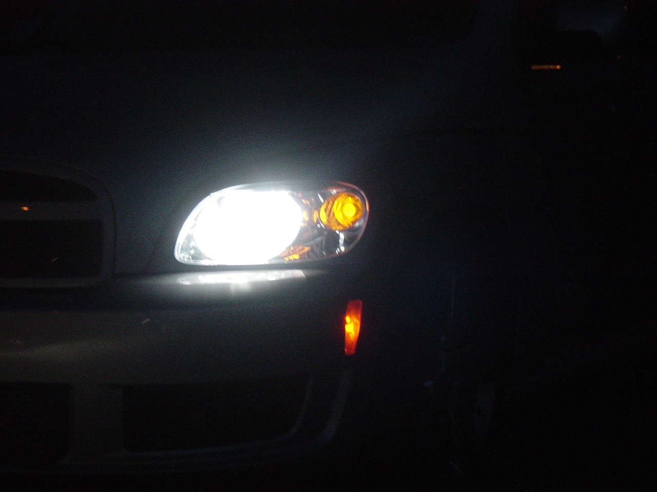

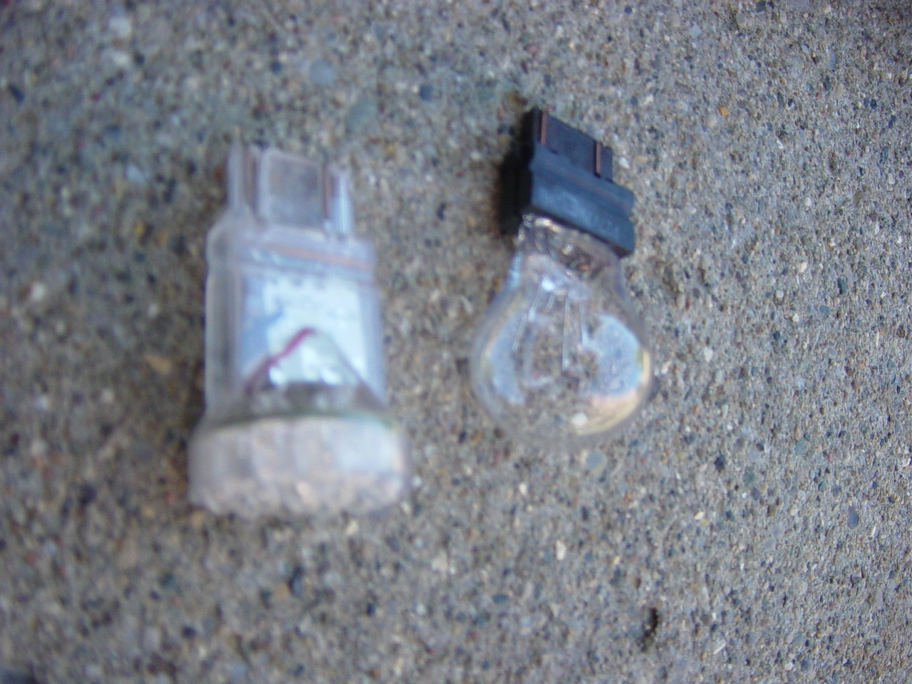

For the front blinkers, I'm currently running the 3157 A-25
But I don't like the way they look. Too small and not enough side light in the reflector and hard to see in the daytime.
So I have now ordered a set A-18 towers. They should be in this week. I can post the results.
