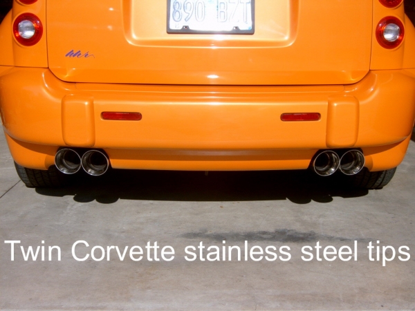

you can check gallery files jefferystuffs, hhr picture gallery shows complete how he did it great photos.

Here is one of the pics that Jay was referring to. Man, that is one sweet looking set of duals coming out of the back of that ride!

Now that Id do.
mhm!

I want that really bad!

Here is the real deal. Rick's Hnewagn had dual exhaust done in early 07. It has a crossover behind the bumper. It sounded pretty good as I remember it.

Anyone know where I can find more photos of this HHR?
