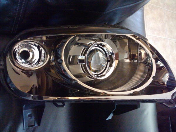

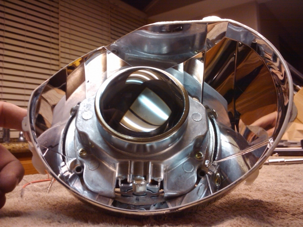

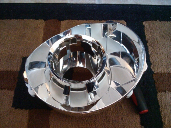

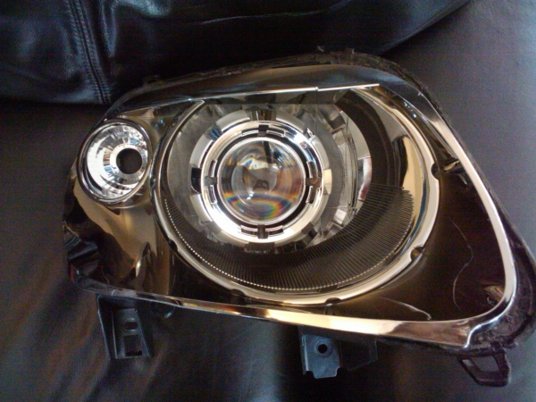

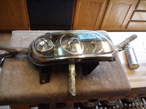

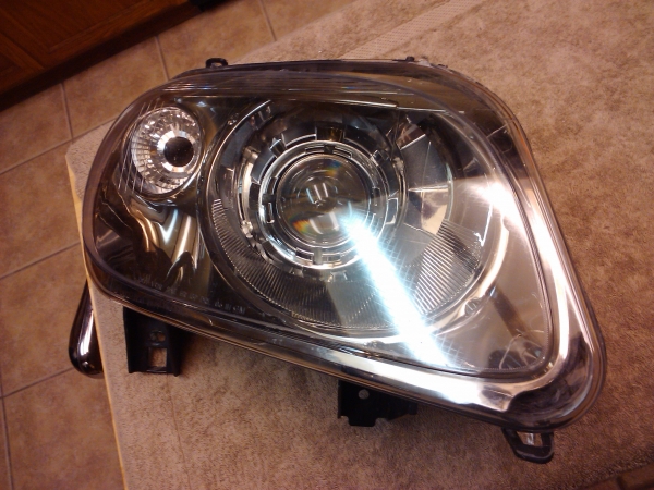

I spent the last few days working on this project. Let me give one piece of advise to anyone that is trying to re-seal your headlights... the "Right Stuff" is awesome, BUT the grey one releases wayyyy too much acidic fumes and it will fog up the lenses. I spent about 5 hours last night trying to wet sand and polish out the inside because of that... So use the black "Right Stuff", and use it sparingly!! Anyways, I have yet to take night time photos but I will share these ones with you. Enjoy!
Will have more pics to come this week and next..

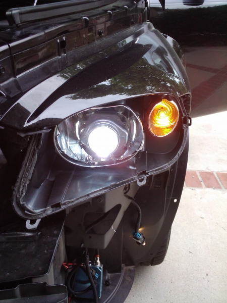

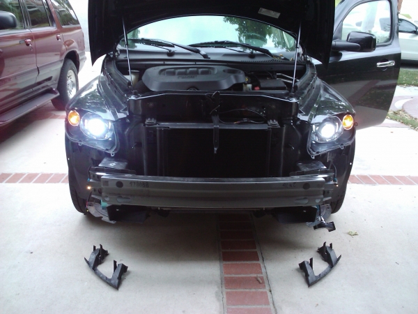

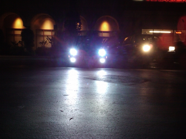

I took a few pics tonight after work. Figured you guys wanted to see a lil more than just a plain retro..DEMON EYES ANYONE?! (SS Fan, i think i got ya beat to your suggestion haha!)
