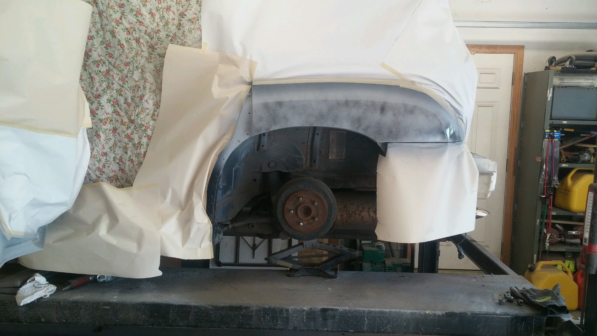

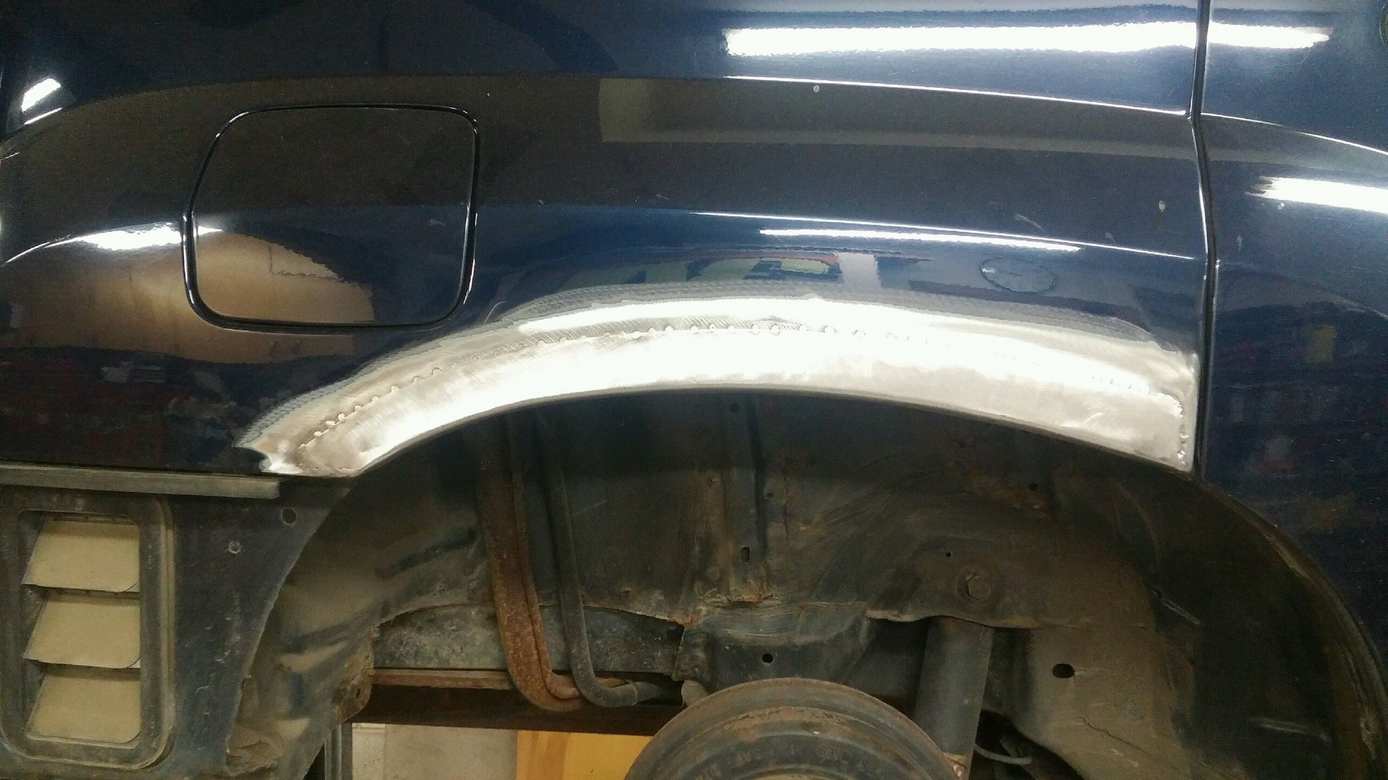

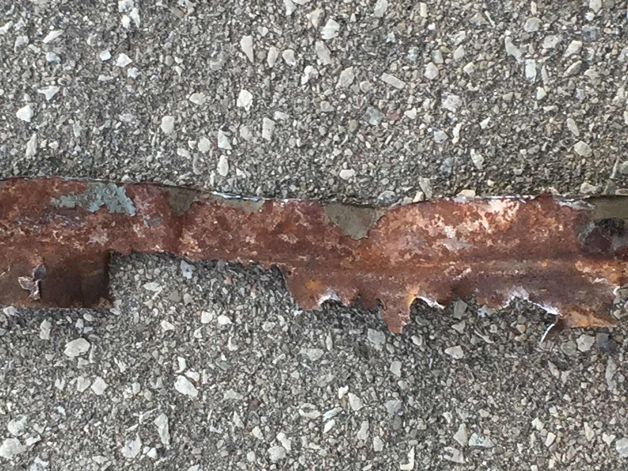

To properly repair rust, cut it out!
Remove the crud
Weld in new patch panel
Use the correct metal prep primers

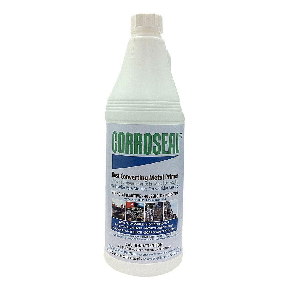

I would use the rust converter on the inside of the door seams.
The Eastwood product I believe has a flex tube with it to reach into areas, but the area has to be cleaned and prepped before using the encapsulator.
If you watch Iron Trap Garage on You Tube, Matt (who works for Eastwood), has used this product lately on a 39 Ford he's fixing.
Rust dissolver is not a rust converter.
A converter drys to a hard film so it can be painted over it.
Here's some stuff from Home Depot that is a primer also.

I have had good results with this...
No, it's not POR15 but it works well and is readily available...

I did go swap for the rust converter instead, Didn't feel like going through the whole wash/dry cycle again. everything was dry but to prevent anything from sticking I silicone the weather strip that contacts the lower part of the door just to be on the safe side.
