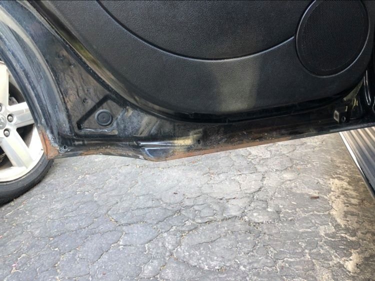

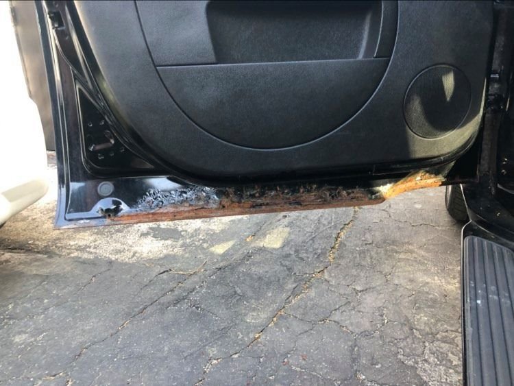

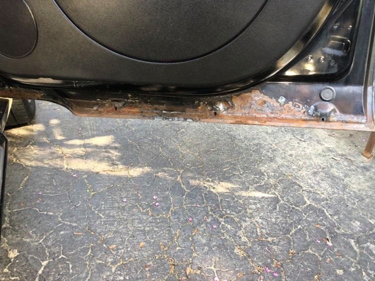

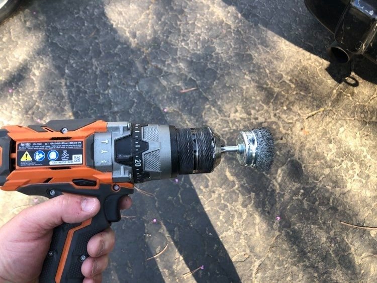

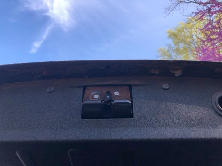

Started removing rust from the bottom of the doors, used a wire wheel to "grind" it off tonight. Tomorrow I will apply rust remover gel and get it into the door as well so it will fight it from both sides of the metal, will scrub it with the wire wheel as it goes and rinse clean with water, then Ill use brake cleaner to "dry" any moisture after blowing it out with air. Once dried it will get primer and paint. I may use undercoating inside the doors to prevent water from rusting it out from the inside. Talked to my buddy who is a bodyman/painter, since there is some clear peel... May try to get it repainted later down the road. But for now, just correcting a little rust issue before it gets worst. (** some pics didn't load to computer hopefully get this fixed soon for the before aft pics.**)
