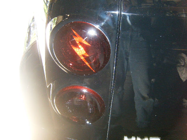

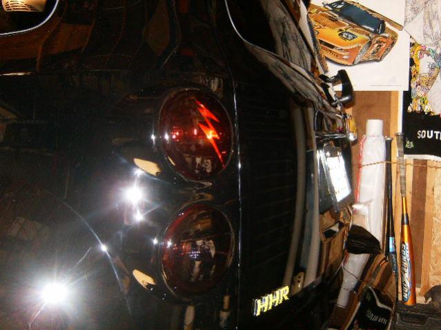

Rust-oleum gloss clear worked great and has held up to many washes and waxes.
lots of dust on some of pics. there super shiny and clean! Got the clear at home depot. 4 coats of niteshades , 3 or 4 coats of clear to taste.

Did you put any coats of the VHT on before you layed the lighting bolt down?

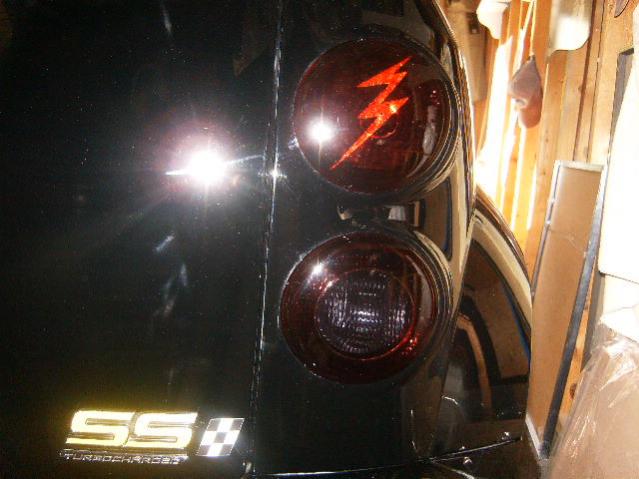

The VHT spray by its self looked real good but I went ahead and put 3-4 coats of dupli-color clear coating and it actually made the finished product look really dull for me. I had planned on re-doing them when I had the chance but I found a good deal on LED lights and I gotta say I have fallen in love with them. I still love the lightning bolt!!!

The bolts were put on the lens before vht. Then carefuly removed while vht was still damp, then after drying , clear coated 3 or 4 times.
The hardest part was placing the bolts on the lens equaly. WAPITA ! but the finnished product is sweet
