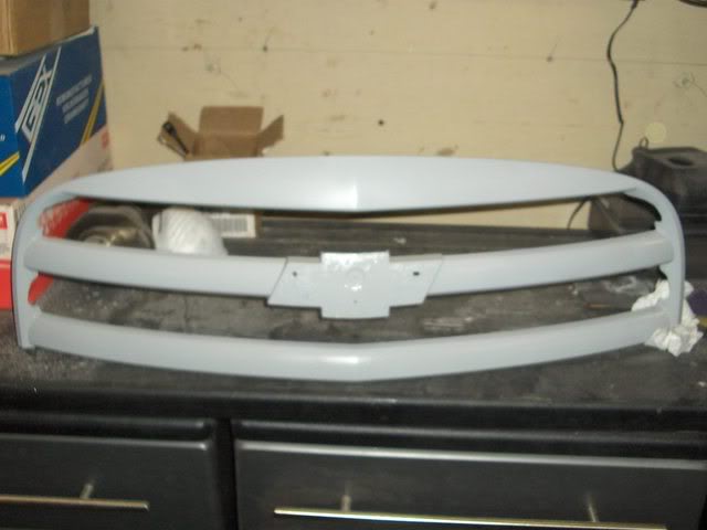

Same goes here except I only need one. You get me a grille and I'll make it for you. Doing one now in the garage.

Here it is after the first primer coat. Needs some sanding yet, but you get the idea.

Assuming you're going to paint it, why not fill in the void left by the louver removal?

Thought about it and may still do it, just have to figure out a way to mold plastic together and make it look good to.

It is going to be painted to match my car. Tonight I filled in the bar holes left with a little fiberglass to see if that will fill in the holes. If your interested let me know, not sure about the chrome though.

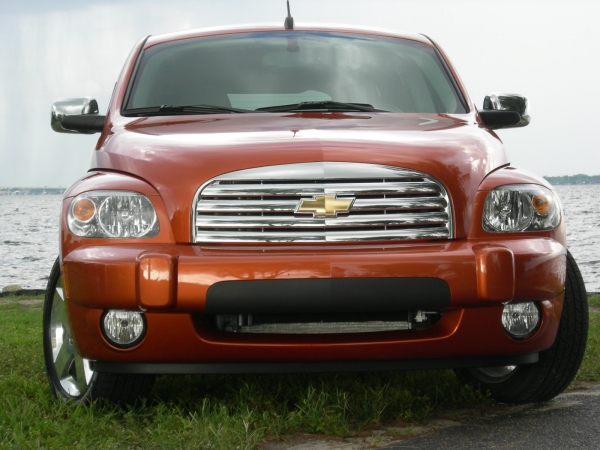

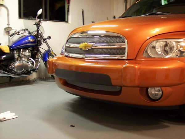

I just finished mine this past weekend. I was able to keep the chrome looking good. It wasn't as difficult as i thought. If you are going to attempt it yourself, make sure you have a steady hand and plenty of time, Total time including making the lower valance grille was about 7 hours, but it was well worth it! Most of the white plastic behind the chrome was easy to grind away at an angle so you don't see it. On the parts that still show, i was able to use some chrome spray paint sprayed into a cup and dabbed with a Q-tip covered it up as to not be as noticeable. I considered painting it as an option but was glad to be able to keep the chrome. I really don't understand why they didn't design the stock grille this way. here are some pics of my before and after.
Before
After
I am not sure I would be interested in making others, well the girlfriend wants one now too, maybe after hers and i have more practice i will take on others. I would be happy to help anyone out if they need it, also the SoCal HHRs website has a HOW TO. that gives you step by step instructions as well.

Okay, the fiberglass didn't work. Let it dry overnight, filled the low spots, then sanded and watched it basically fall off. Guess I will just leave the cut outs.
