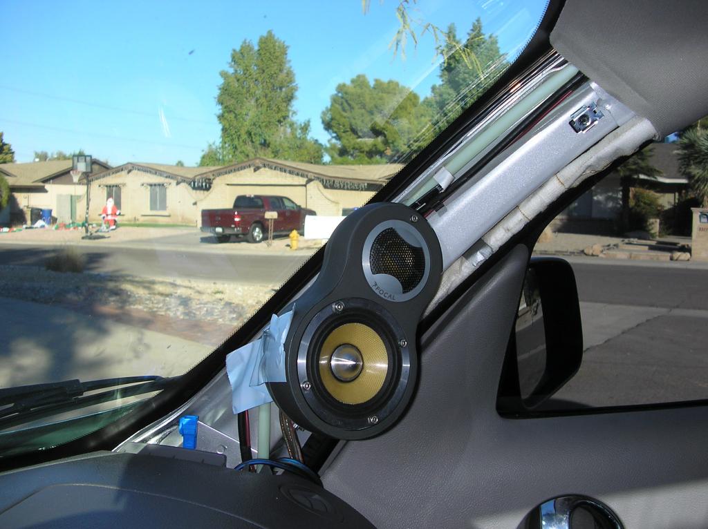

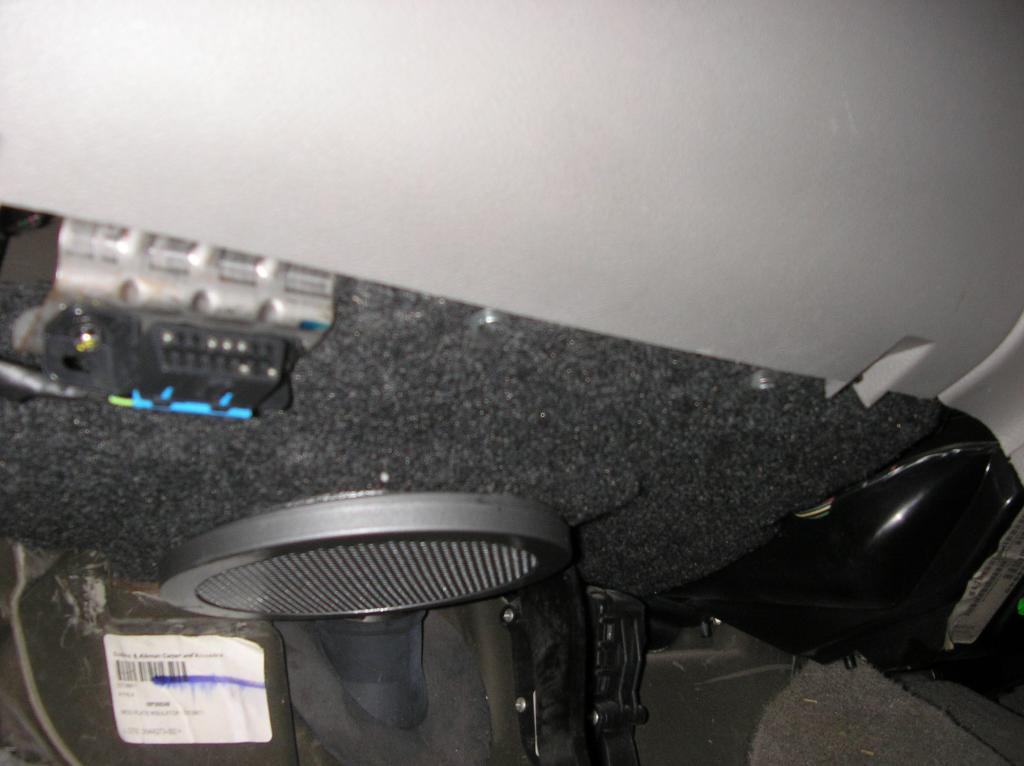

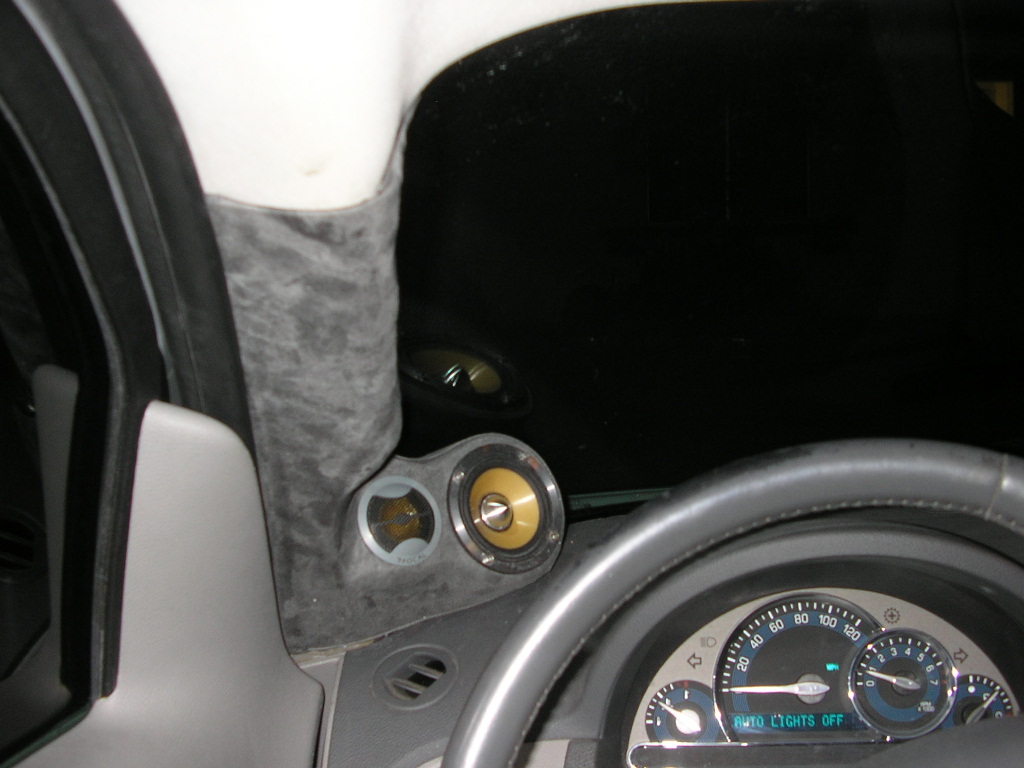

Old Nov 6, 2013 | 01:52 AM
The Real Subzero's Avatar
Joined: 11-07-2012
Posts: 47
From: Chandler, AZ

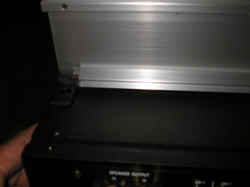

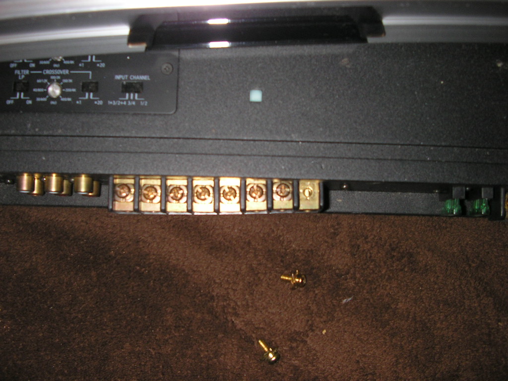

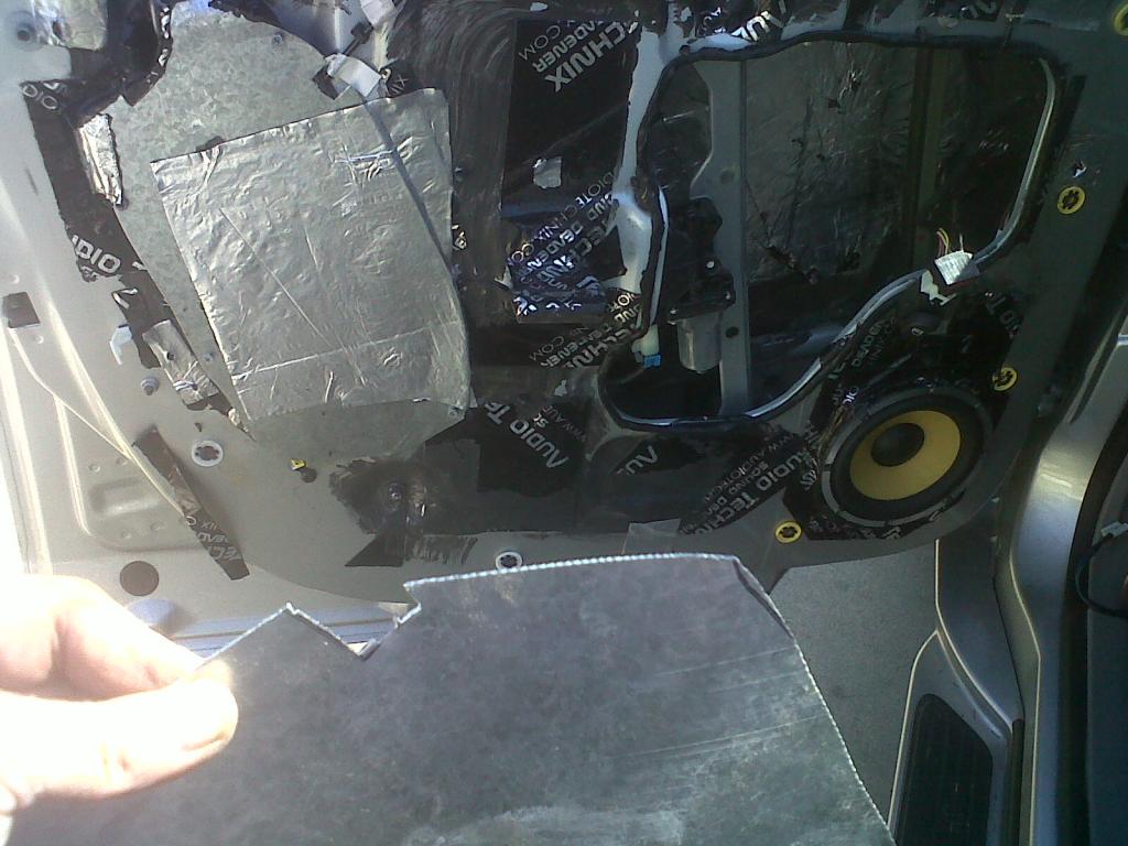

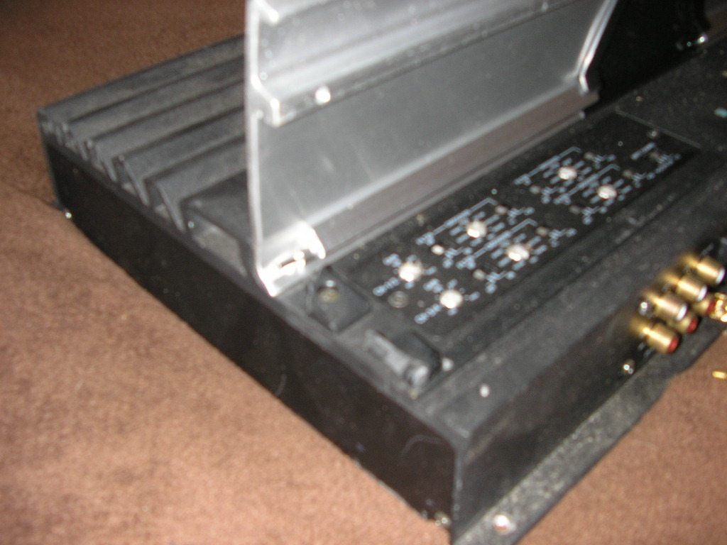

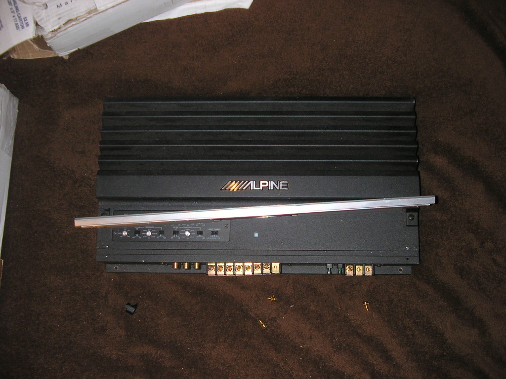

SO when I recieved my amps, dude did not pad. this was the result/

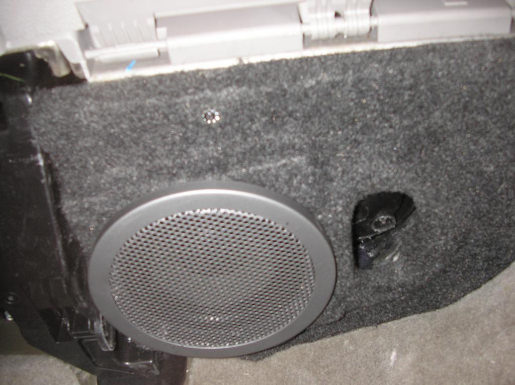

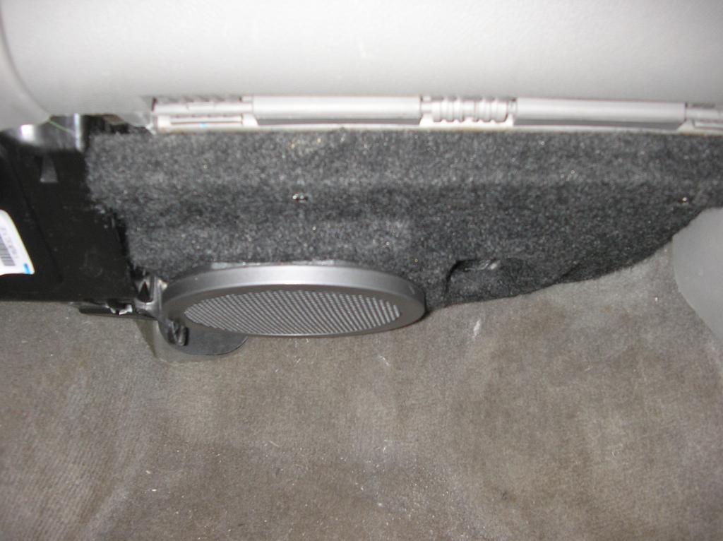

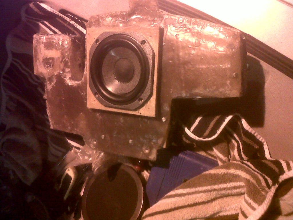

The next thing I completed was the midbass boxes.

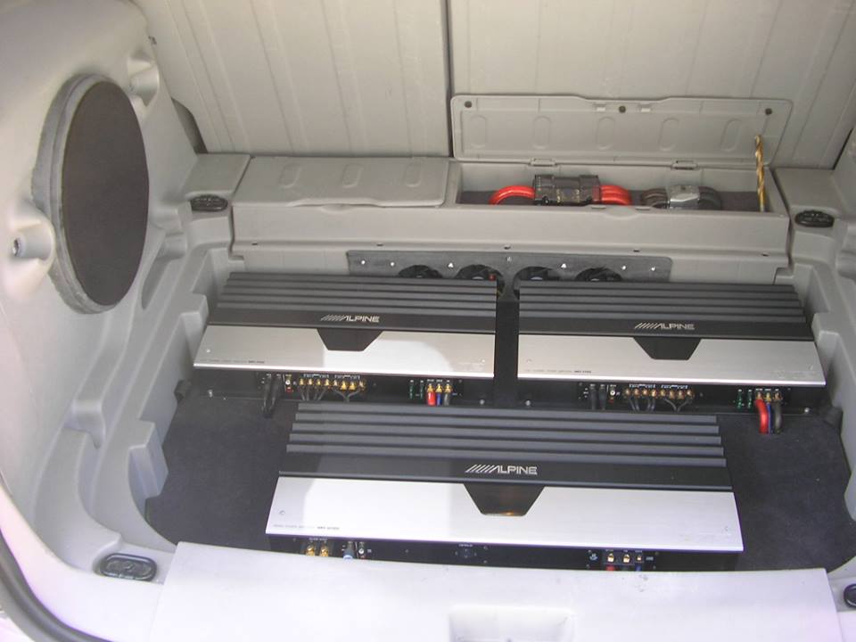

Joined: 11-07-2012
Posts: 47
From: Chandler, AZ

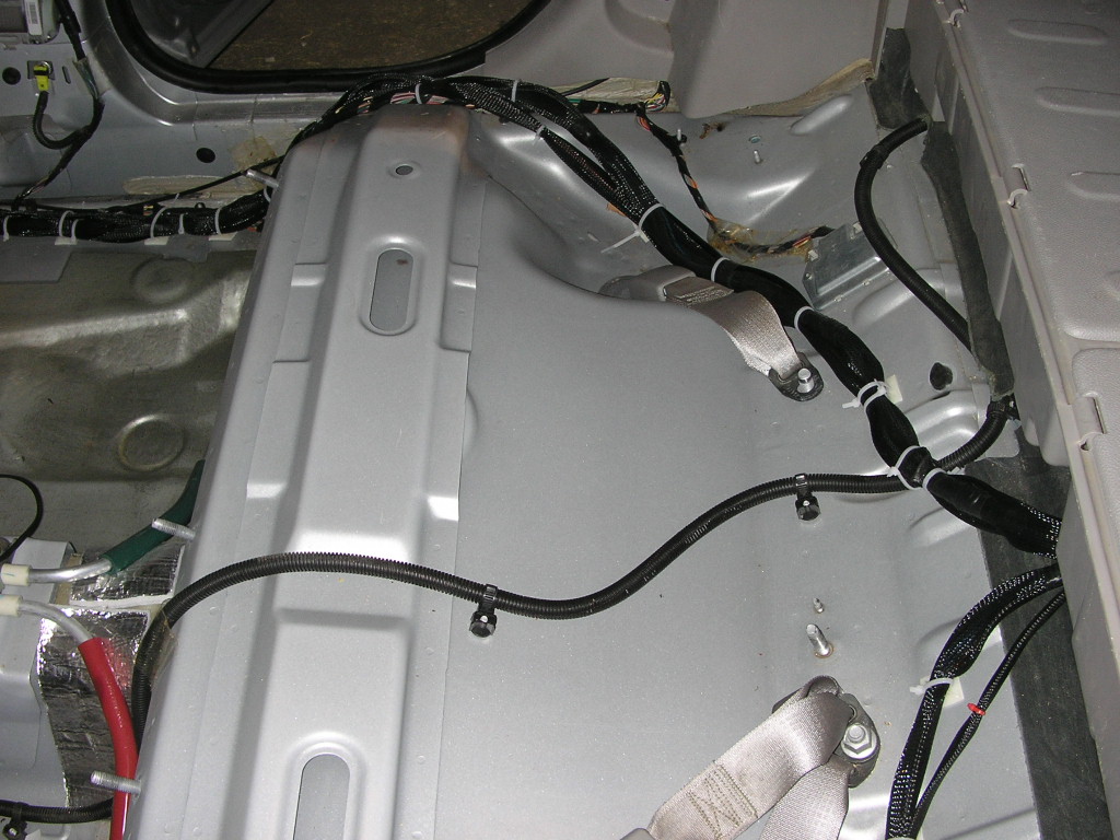

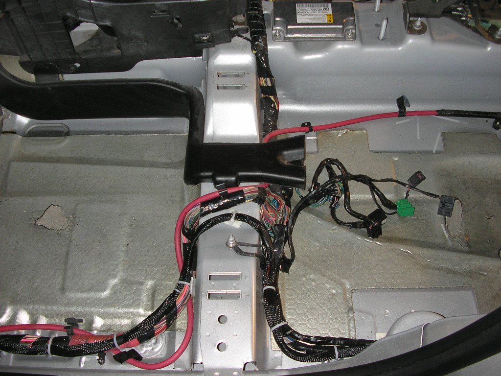

all I added was a second battery. stock alt does fine. these amps dont draw much current. 1/0 from bats to fuse block, 1/0 ground to distro block. 4awg to all the amps.
here are some more random ass pictures.

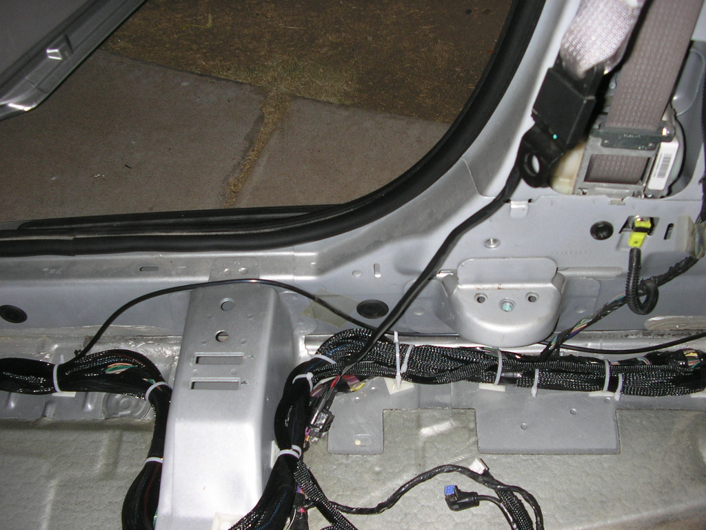

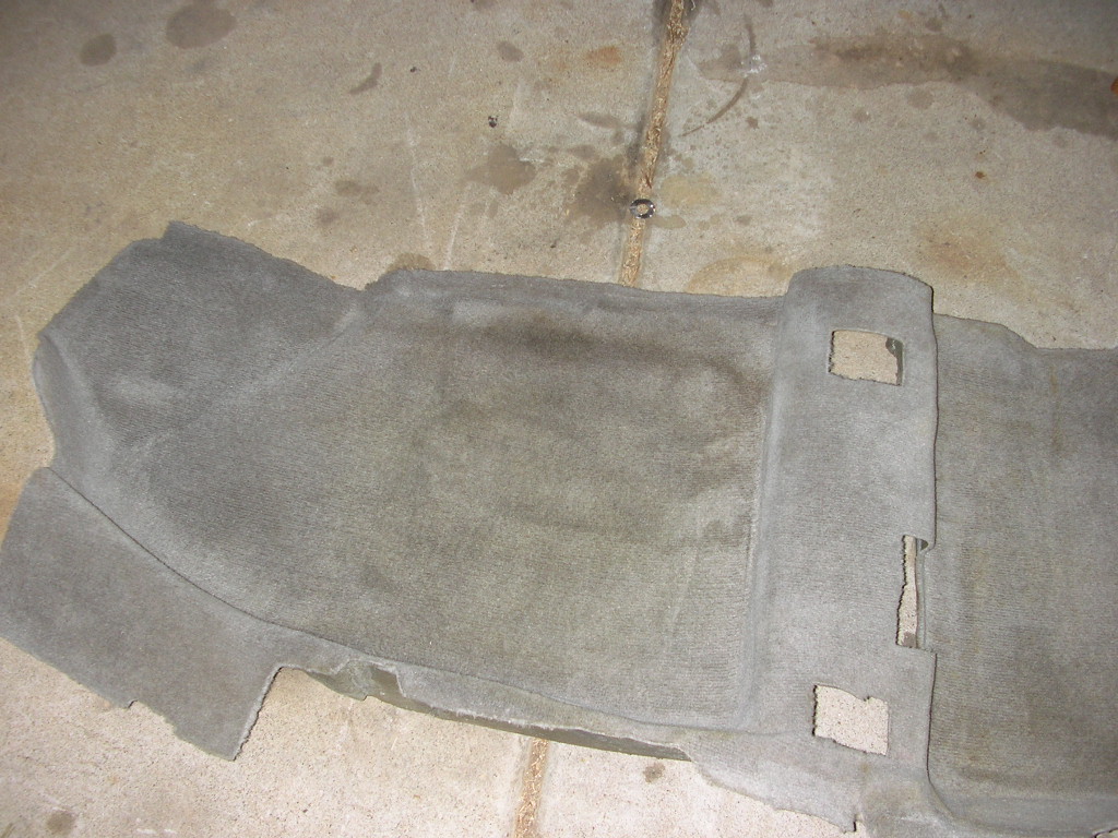

Old Nov 6, 2013 | 02:05 AM
Joined: 11-07-2012
Posts: 47
From: Chandler, AZ
I am going to try and get a new floor carpet. the previouse owner ****ed this carpet up bad
