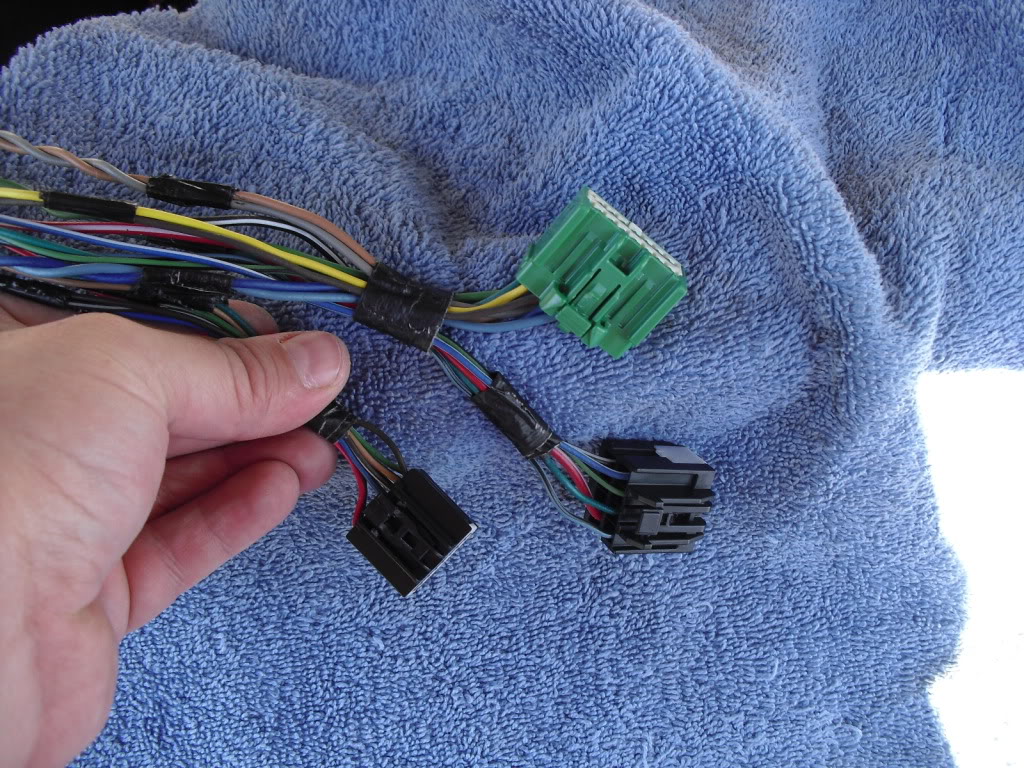

Not sure if you have pulled the rear panel yet but here are some pics of the factory amps 3 connectors and the wires.
In this pic the top (Green) connector contains the speaker out wires. For mine the pairs were taped and twisted as you can see with the tan and grey (left front). You can see the Dark blue and lt blue (right rear) pair and the yellow and brown (left rear) pair too. Note that these wires are a larger gauge then most other wires. The smaller black (bottom) connector contains the pink remote on wire. You can see it as the bottom most wire in that connector. This bottom connector also contains the input signal wires comming from the HU.

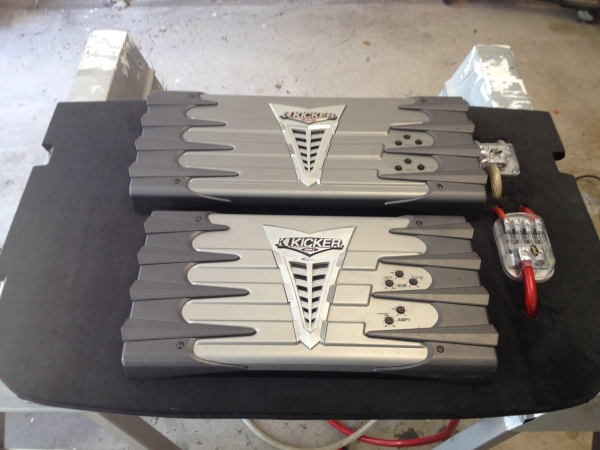

Kicker Amps via miltonfisher .
