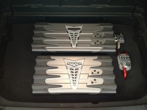

There you go , posting pics now ....
It will be nice with that many channels and the 360 to do what you are aiming for ..
See you at the finals !!!!!!!

using the stock head unit for now may look into getting something with a display at a latter date. I have done some research and found that the stock unit does ok as long as you can flatten the signal and start over to get all the frequencies in balance and maybe boost the mid bass and sub bass to compensate for the road noise and I think I can do that with this setup, we'll see. if not i'll be looking at other options. I'll be working on the rest of the build next week, first the tweets then the final step will be tapping into the factory amp that way maybe I wont have to ride around with no sound. I'm hoping to be able to tie all components together in one day, then a few months of tuning to get it the way I like it. I also want to get Scott to tune it for comp seeing as the 360 can hold 4 presets in case I get the bug again.

Yep not a lot of volume on the factory setup but I have my fingers crossed that by adding the RF 3sixty.3 and the two amps I will be able to get the volume and quality I am looking for and it will allow me to control tweets, front doors, rear doors and sub independently and get the proper cross over points in all 4 areas. I am hopping that by doing that I wont need very much EQ except to boost mid bass and sub bass, we'll see. But thanks for the heads up on the Head Unit I'll keep that in mind.

Does anyone have any Idea on how to pipe ac to the rear cargo area where the spare tire is? most of my trips are short but on a long haul there might be a heat issue and fans are noisy. I know there are ducts under the front seats but cant think of a way to without it being noticeable to get them to the rear. Or a very very quiet fan. For now I think I will just put spacers under the amps so what little air flow I do get back there can flow under the amps. I don't know what does everyone think?

The squirrel cage fans from stinger move a lot of air and are super quite. Use a relay nd trigger the turn on with your remote amp trigger. That's one option...
