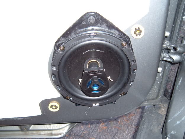

A couple shots of them in my HHR:

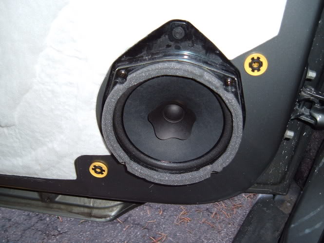

Originally Posted by SoCalHHR
I don't think I'd change the fronts out. I've done some extensive listening against many aftermarket speaks, and the front setup is actually components (6-1/2 woofer, 1-in tweeter, with x-over).
They are actual crappy components. I haven't seen the tweeters or sub yet but the speaker in front doors are the exact same as the speakers in the rear doors. All paper cone crap:
Here is a shot of the front in place:
Hardly what I would call a good component set up. I am so glad I replaced the fronts, it improved the sound so much. Better bass responce and cleaner sound. I am kind of pissed at Chevy for passing this crap off as "premium". I can't wait to see the premium tweeters and sub.

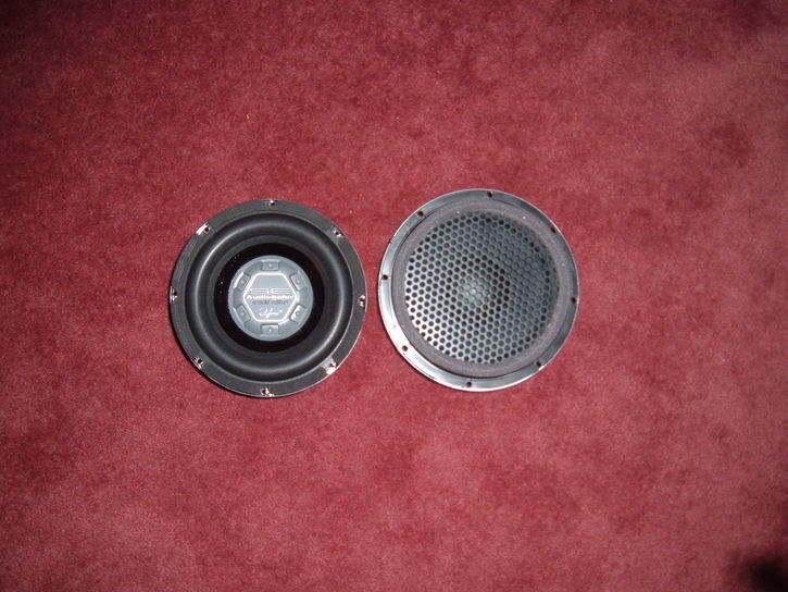

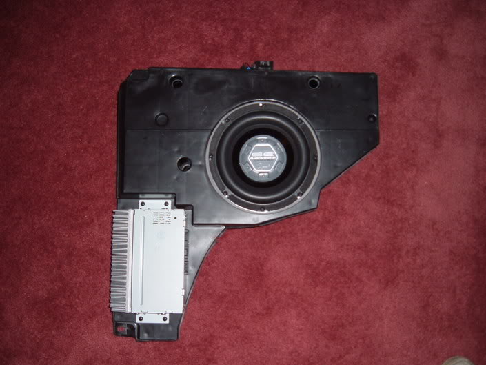

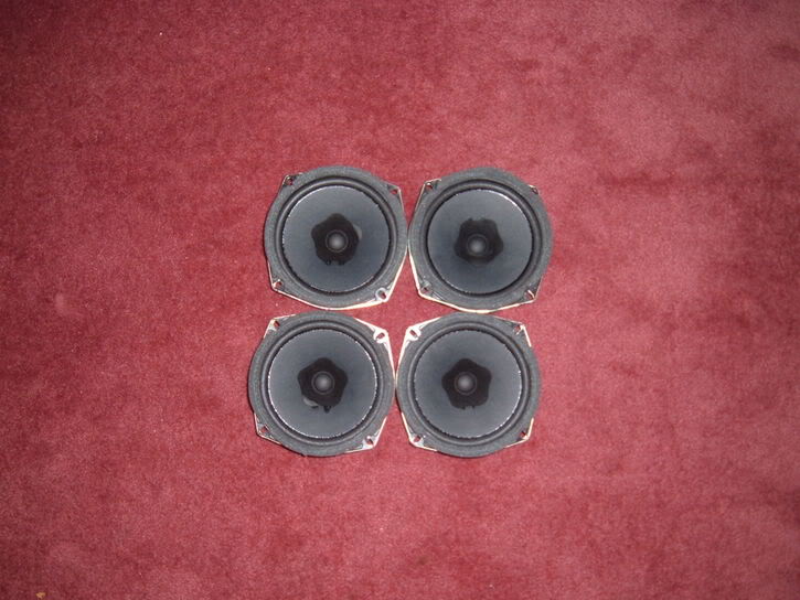

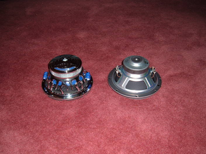

Side by sides of the subs and the Audibahn sub installed in the factory box:
To my surprise the factory sub was already a DVC sub so wiring was easy. For some reason Chevy's wires are the exact opposite of what you would expect. Black is + and red is -. The sub was a little more of a pain in the a** than the easy door speakers. I'm doing my tweeters in the A-pillars tomorrow and then I'll be done with my audio for a while.

Dual voice coil subwoofer. It is the factory amp I just upgraded the speakers. It is loud enough for my daily driver vehicle but the factory speakers sound like crap. Of course my system is no louder now but it sure sounds a lot better.The factory amp has three conectors. There is no way in hell you are going to fit larger than an 8" sub in the factory box. I had to put in a spacer ring in order to to make the Audiobahn fit. It was the right diameter but you can see from the pics how much larger and deeper it is. If you meant a larger amp the answer is also no, but there is a lot of room in the spare tire area for one plus your battery is right there. If you want to leave the tweeters thats up to you but I chose to replace everything. I would say if you plan on putting three ways in your front door remove the tweeter like I did. I don't think you have to add foam. I have had no problems with rattles. Maybe if you are going for a compitition set up I would go the extra step. You will find that the HHR had quite a lot of sound deadening material already installed. The pins that hold the door on are rubbery plastic that are designed to not make noise. Hopefully that answers all your questions. Any others feel free to ask.
