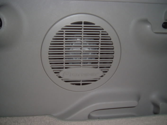

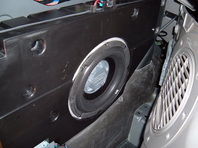

I have one: since you had to install a spacer ring to add room for the deeper basket and magnet, how will you fit the side panel back on? Are you planning on cutting a hole? Adding a new grille?
It fit just fine. It doesn't stick out any further than the factory sub:

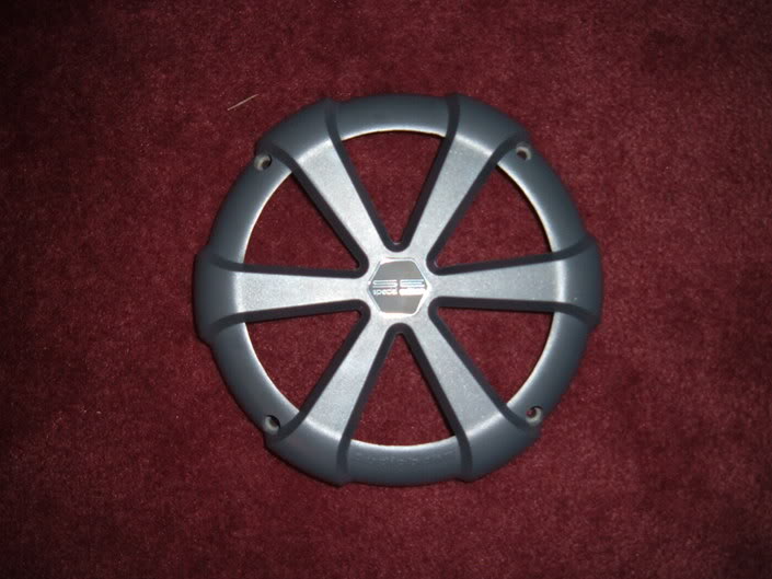

I didn't have to change anything. Remember the factory sub has that stupid plastic grille covering it so there is plenty of room between the sub and panel. I needed the ring so I had something to screw into without leaving a gap (I'm sure you don't need an explanation for that one ). I am going to add my own grille for purely cosmetic reasons, it just hasn't got here yet. I'm getting rid of the Pioneer one and putting on a flaming chrome Audiobahn one. The factory grille is melted on so you just have to cut it out. The grille that came with the sub is just ugly so I had to buy the nice one seperately.The one that came with the sub:

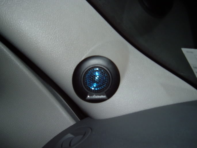

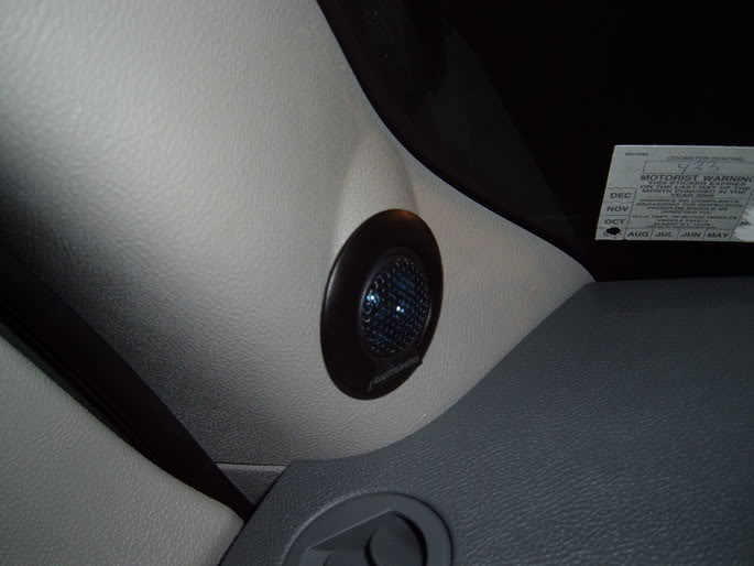

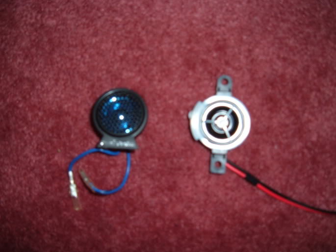

Tweeters done:

Now I just have to pull the sub box one more time to play with some polyfill and put my new improved spacer ring on. I'm going to wait untill my grille gets here so I can do it all at the same time.

No, I dont have side airbags. Pulling the A pillars out is simple. At the top of the A pillar is an oval cover, pop it off .I used my fingers but you can use a flat head if you want. Inside is a T15 Torx screw, remove it. Grab at the top and pull. About halfway down is a clip that just pops out. At the bottom there is a female slot in the dash that a male side on the A pillar slides into. Be carefull when you pull it because of the tweeter wires. Disconnect the plug. The tweeter is held in by two T10 Torx screws and uses the same black and red wires as the sub (Black is + Red is -). From there do as you want. I had to cut two large holes in the A pillars to fit in the tweeter housings. I wanted to keep the fact that they are adjustable so I used the Audiobahn surface mounts. After I cut a large enough hole and had the housing in place I went out and test fitted them so I could properly align the Audiobahn logos. I notched the plastic so the tweeters were flush then wired them up and reinstalled them. Not hard what so ever. The hardest part just like the grille was chopping up the factory parts. It is so much easier chopping up someone elses ride.

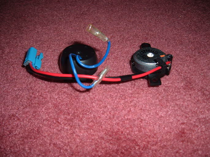

Earlier my discusion with snksknr94 made me think that I should better describe myself and maybe I shouldn't have just said wire in the tweeter. You are also going to have to wire in a capacitor unless you want bass coming through your tweeter if you go the aftermarket route. The Chevy factory tweeter has one built in as you can kind of see from the pic. I put in an inline one instead. Unless of course your puting in a crossover or matched component set.
