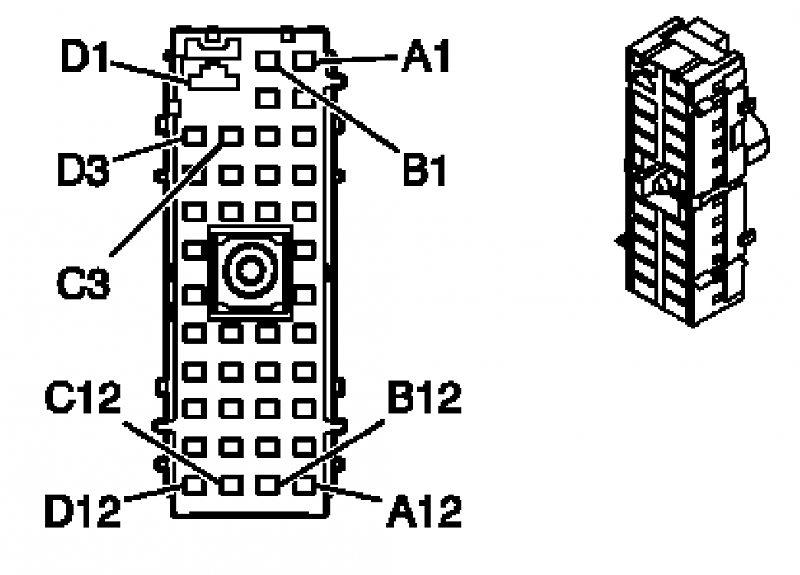

Posts: 26,533
It will be a red/white wire coming out of the BCM,connector C3, position D11
