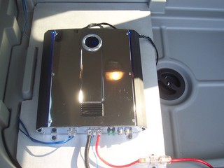

Also I made my amp rack to fit in between the spare tire and shelf so it is hidden.
