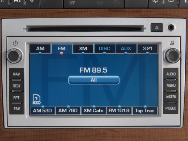

Was wondering if anyone had the idea of putting the navigation from the 1st gen Equinox/Torrent in the HHR. GM part # 20801306. I would get the 2009 model since it is equipped with the bluetooth feature since i have a 09 hhr ss. It is the same size and they use the same non navigation radios we have in our cars and wouldn't see why it wouldn't work.

you need to figure out what it will need for a GPS antenna and might have to re pin the radio harness because they most likely are different

I think the biggest hurdle might be whether or not it will interface with the HHR's BCM, or whether it could be made to interface with the HHR at all.

I don't think it will work. The navigation radio uses the OnStar module, which I am sure are different. Plus since the Radio/Nav Unit is not made for the HHR it probably won't program to the vehicle.

Two different vehicle platforms, Delta(HHR, Cobalt, G-5, Ion) vs. Theta(Equinox, Torrent, Vue, Antera, Suzuki XL-7). Its really an apples to oranges deal, all GM vehicles aren't alike electronically.
