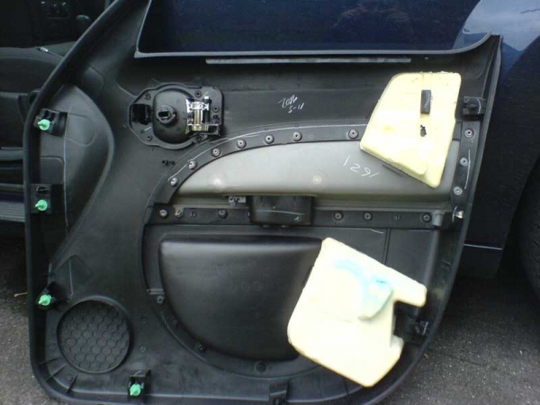

Does anyone have any pictures of what they did when the door panels were off ?

Ya Ill put some up. I didnt use deadener (yet), just put in new speakers. I had the base system, which means I had to make adapter rings. The premium system has speakers that can be removed from factory rings, so you may be able to reuse them for aftermarket speakers.

Heres some pics, I have more if you want something more specific, let me know.
