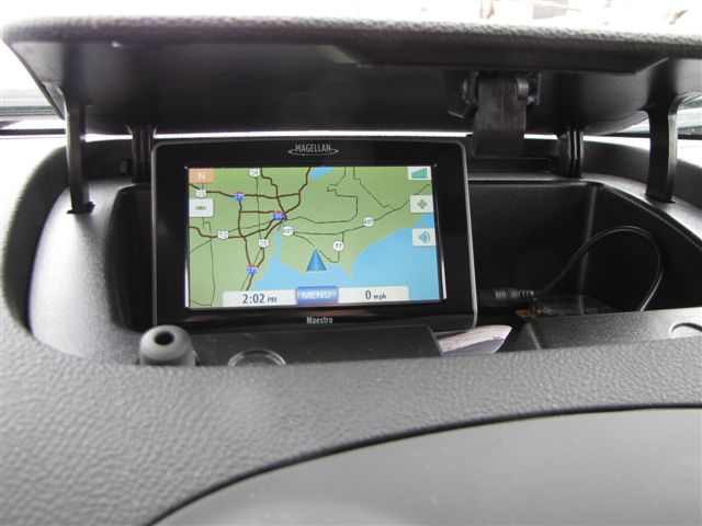

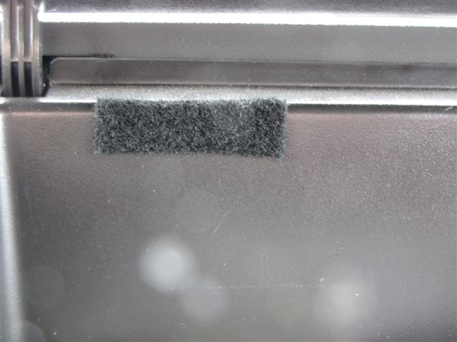

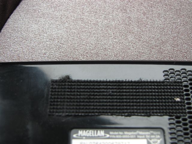

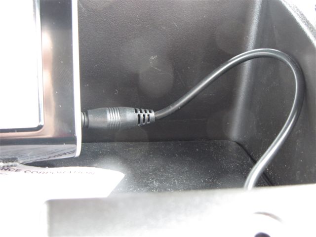

I went a different route when I did mine after I hard wired it to the power outlet I put in a 3 amp in line fuse then ran the wire up to the glove box.On the backside of the lid there is a little shock absorber for the arms.I just slid it up some till the lid opens just enough to see my GPS.The lid is still low enough that it does not block your vision of the road.
All I did was put a bit of velcro on the inside of box and backside of the GPS when I use it I just set it up and aline the velcro.When I park it just pull it off the velcro and lay it down and shut the lid out of site.
Best part of doing it this way is the screen is always shaded and is nice and bright on the sunny days in any direction you drive.
