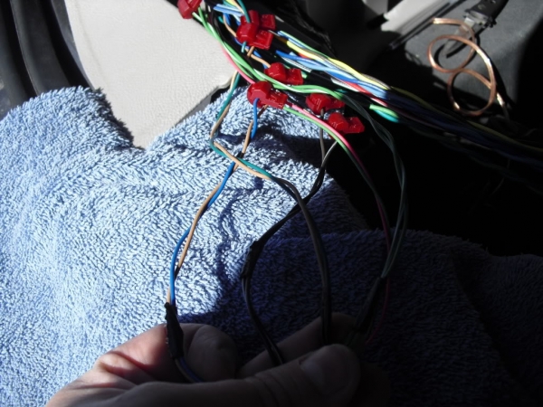

i thought i was done with my entire wiring... to find out i am not getting any power... i am almost 100% positive that it is the remote wire. I looked at the diagram and it showed that the lt. green wire is the remote. but still nothing. any help is greatly appreciated.

oops my bad it was getting late last night, i am wiring up a aftermarket amp from my pioneer stock amp. used the diagram and for some reason it isnt even kicking on showing there is power. got the remote hooked up and all

Remote wire is usually blue I believe. Not completely sure about yours though since there was a stock amp.

The remote wire at the factory Pioneer amp in the back is PINK.

It is the pink on running next to the l. grn in this pic.

I figured it out the other night, this is the first time i could get on here... now have a 2500W amp pushing 2 12" subs
