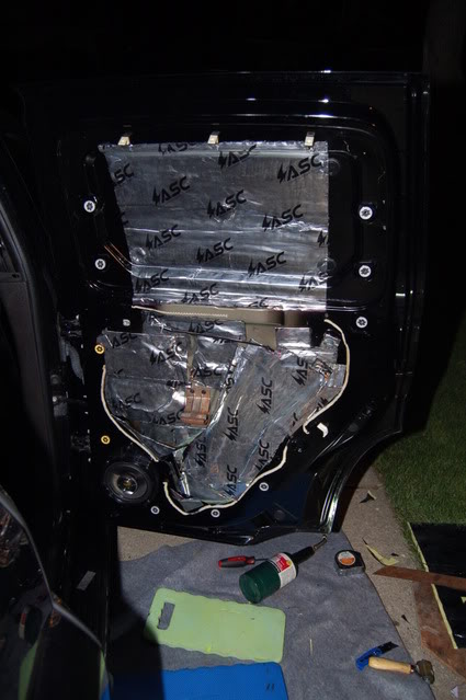

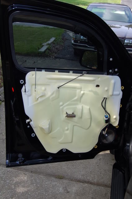

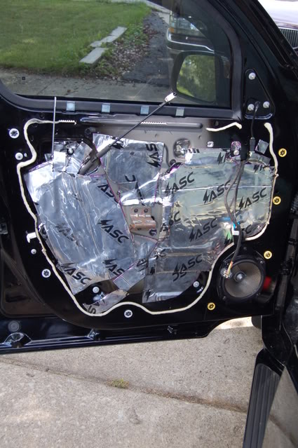

A little more on topic, I got the Drivers door finished up ready for the interior door panel.
I lazed out all day after working on this door from 3am-6am. Have been calling for thunderstorms today so after putting everything away Early this morning I just havent gone back out there to work on the rear doors.
Think I will go out and try to get one of the rear doors done this evening before it storms.

Nice project AP. Now you've got me thinking about this too. I don't really want to do this for a stereo system though. I am getting a little bugged by the Magnaflow muffler drone. Its not bad, just a little annoying when I am cruising around town. I would think the audio barrier would help. Let me know what you think since you obviously have experience with this stuff. I was thinking that if I did the floor it would help make the HHR feel solid and maybe drown out the cabin drone and road noise a bit? Also how much do you think would be needed to do the floor as you have? Also is this stuff like foamy or is it pretty solid butyl rubber like it advertises?

Thanks Freek.
Sound deadening helps in a few ways. And it depends on what your after in how you should go about achieving it.
Basically it helps in 3 ways, dampens vibrations, quiets road noise into the cabin, and heat/cold.
Not the best on the heat and cold alone, if thats what a person is after they should also use a top layer of something like Ensolite. There are Tons of different products out there and everyone and their Mother has opinions on what and how you should do it.
I would suggest also getting Some Ensolite for muffer noise with the Sound Barrier.
My Main concerne was for creating a Good Audio enviorment inside. I did not take the extra Ensolite step, I thought I would do what I have done and go from there if I needed to add another layer of something.
So far, I do not think I will be adding anything, the Panel is Dead Quiet. The Doors feel 10Xs Better much more Solid feeling and far Less noise.
Tap on any of my sheetmetal and it's a Solid Thump sound now.
OrangeWhip was here and was Impressed with how Solid the car sounds now.
The whole Panel has a much more Solid feeling to it overall.
It's well worth the added cost and effort IMO.
It is Not a "foam" at all its a sold Butyl Rubber, very sticky.
I installed most of it in 90 degree temps so it was Very Sticky and more pliable, I did Not need to use a propane torch or heat gun.
I have used the propane torch on a couple of the doors doing them overnights with much cooler temps. mid 70's - upper 60's at night.
Be Careful with heating it, it turns soft and gooey Quick and the backing is hard to peel off.
I can give you some Tips and answer any questions you have anytime you want.
I'd say just the floor, you'll want 1 Bulk Kit (72 Sq Ft)
And something like the Ensolite to go over that and you should be pretty darn Quiet inside.

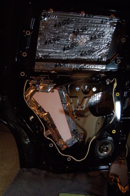

Just finished up the rear passenger door, only 1 left to do now.

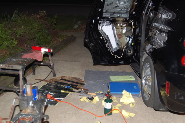

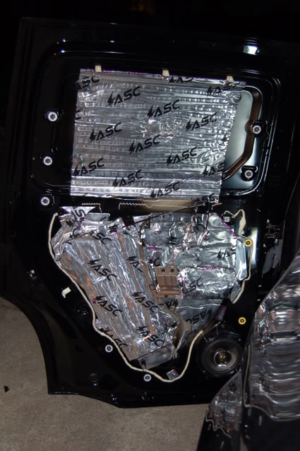

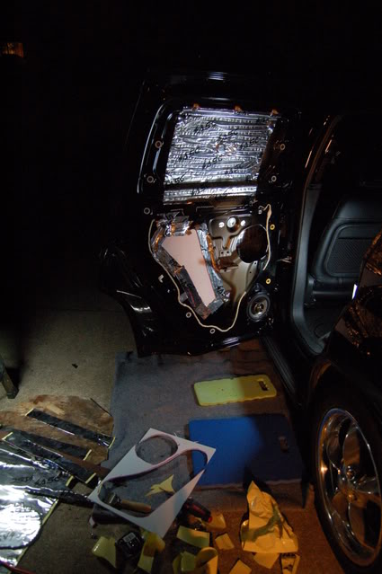

Well it's 4:30 AM and I Finished the last door, Drivers Side Rear.
Now I am DONE with the Audio Barrier with about a 1/2 sheet left.
Still gotta reinstall the interior door panels, installed the passenger front the other day, so I have 3 to go.
A few minor things left to do yet but the Bulk of this project is Done.
