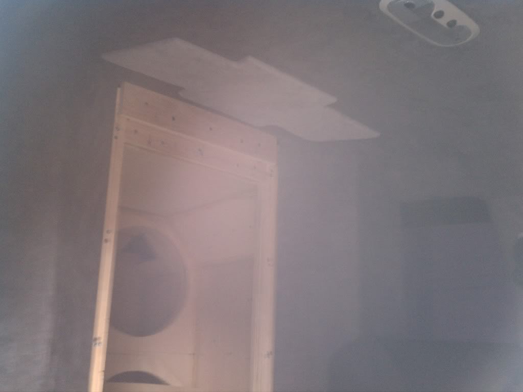

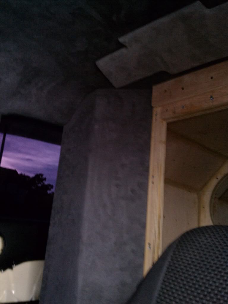

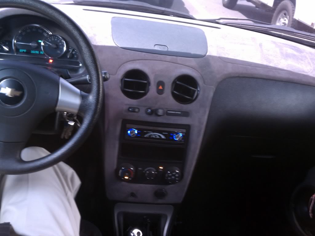

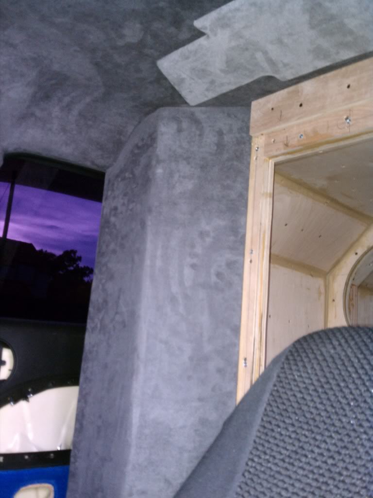

bad pics, covered pieces of the trim panel on the wall too. not screwed in just yet.
starting to look like something though lol

Nice work, but I've got to ask, how do you get to the battery?

i can still access the battery, barely :)
