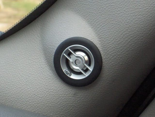

Here are some pics I took of mine this morning.
These have a mounting ring behind the pillare panel that holds them in place and about five feet of wiring to run to your crossover. They don't quite follow the curve of the panel, but you'll never notice and probably never find ones that do anyway.
