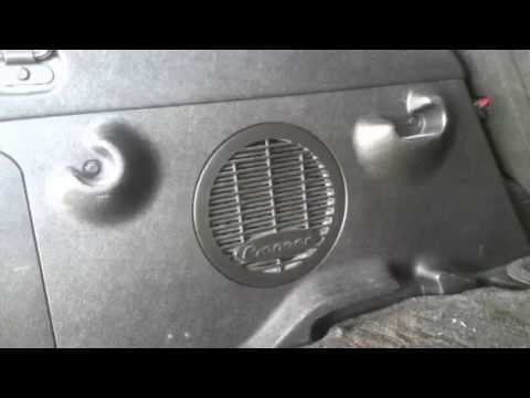

I'd be interested in seeing the label. Never heard of speaker delete before.
Ditto.
What year and model is it also.

Both of my SSes (AA5 and Panel) came with rear speakers and sub.

So I guess you have the upgraded radio in them ?
Do you have the rear speaker by the lift gate ?

That rear speaker by the lift gate is the subwoofer
Came with the upgraded Pioneer seven speaker sound system with an amplifier RPO code UQ3
