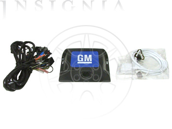

Personal Audio Link
Part Number: 19201522
Link Your Apple® iPod® w/ Your Factory Radio (w/ RPO Code US8, US9, w/o RPO Code U1C)

Originally Posted by tplyons
Is it easy enough to install myself? Or should I have the dealer do it?
It will work with the 2007 LS, right?
Easy to install? No
Dealer do it? Yes
It will work as long as you have the option codes US8, US9 and don't have option code U1C. Spid label is in your glove box.
Simple way to know is if you have a radio with a CAT button on the right hand side it should work.
The part number is for a 2007 LS or LT. I have it in my 2007 LT
