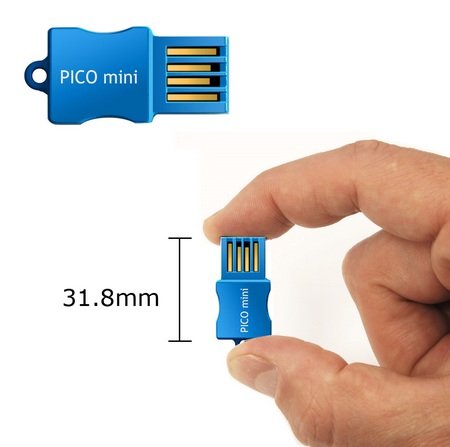

I had a PAL in my HHR and took it out. It was to slow and combersome.
I put in a stock radio in with the USB port....loaded my music (MP3) on a
USB 32GB pico drive and it is 100 times faster than the PAL was in loading and scrolling threw songs. Displays music just like PAL. You can do sub folders too...read the manual.

Remeber not all USB drives will work in the port. The radio is picky. The Pico hasnt failed me going on 4yrs. I have several Picos.
I tried a Maxell Onyx which is super tiny and it wouldnt work after the second start and the drive got hot too.
