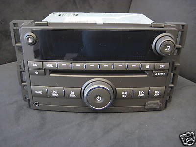

I have the PAL installed and find it very slow.
I just bought a stock 2009 Radio head off ebay with the new USB interface on the front (plays WMA MP3 AAC iPods and memory sticks throught the USB). Memory sticks are cheaper than iPods :)
I will compare the two and post here.
Notice bottom right side of radio. USB connector

I was thinking of doing the same even though I have the PAL controller. I thought maybe the USB connector would work a bit better but I wanted to read some reviews and feedback first. If you install this and have an iPod please post a followup.

Since you bought a new radio. Didn't I read someplace that the dealer has to flash the radio ? ? something about vin verification to limit stolen property.
You are correct.

Yes,
Since I bought a used radio I will have to go to the dealer and have what is called a VIN RELEARN done with the Tech II scan tool.
When You pull a radio from one car and sick in another the vin # from the pulled car is in the radio and dosnt match yours. puttting the radio in theft lockout mode.

Originally Posted by Pretzel
From what Ive read if you buy a new radio it dosnt need a relearn and picks and stores your vin when installed.
Craig~
If it is a GM radio it has to be set up with the tech II scanner whether it's new, reman'd or used.
