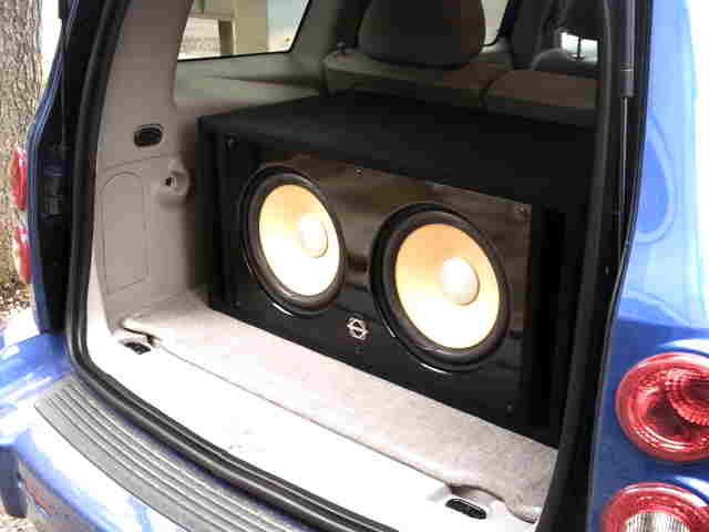

My audiobahn (dual 10's above), is tuned to 50hz, and with a 6db/octave slope and +1 or 2 db at 63hz it sounds very nice on jazz and alt rock stuff. It will in no way impress someone looking for "bump" though.
I'm SUPER happy with it's performance in my HHR - but then my head unit (Pioneer 8600), offers lots of flexibility in setting up subs.

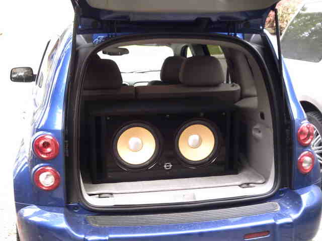

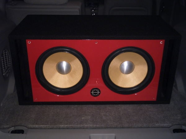

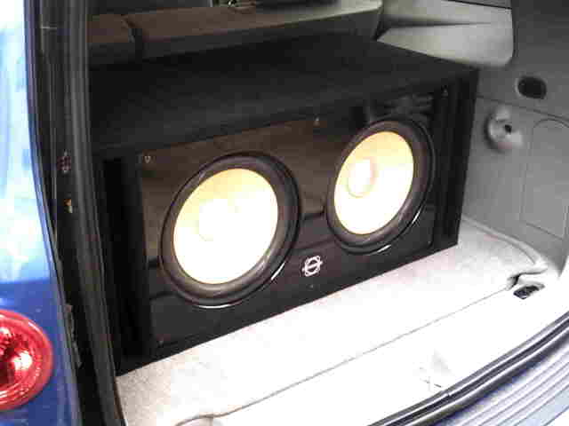

I too recommend that you run a much smaller box if cargo space is an issue, although i wouldn't make any decisions until you know what subs you're going to run because different subs have have different internal volume specs (depending on if the box is sealed or ported. The setup socal is running is nice but i personally like to announce my presence before i arrive. Here are updated pics of my box.
