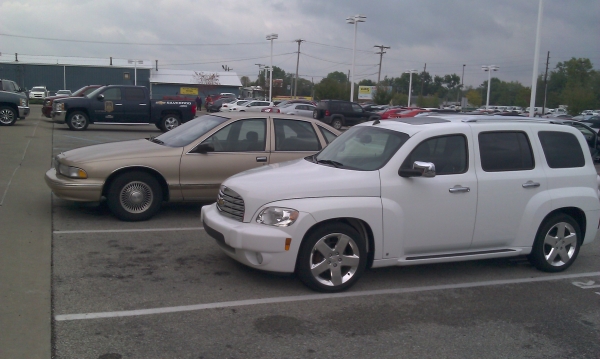

Sitting next to my old car before leaving the dealer today.
You def took a BIG step up in style with this trade in
Chevy's run strong. It was hard to let go of the caprice but cruizing off the lot in the HHR made it easier.
