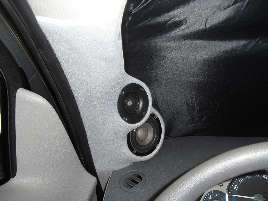

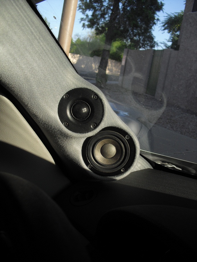

Fibergalssing the pillars for just tweets should not be all that hard. I just installed mids and tweets in mine.
