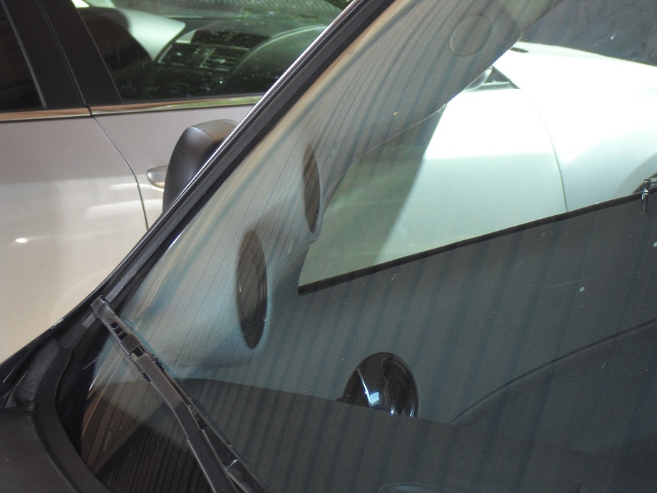

Those turned out pretty kick ass! What drivers did you use there? Any more abouts of your system?
Old Oct 3, 2012 | 10:10 PM
07azhhr's Avatar
Joined: 10-06-2011
Posts: 1,150
From: Mesa, AZ
Those are SB Acoustic tweeters and Hybrid Audio Legatia L3's. I am still running my factory hu until next week when I will be installing a Pioneer DEH-80prs. I still have to decide what 8 inch midbasses I want to use in the doors and get more amp channels to take better advantage of the Pioneer.

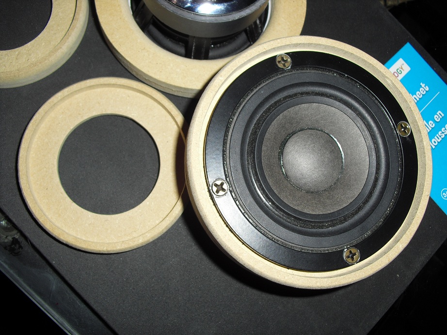

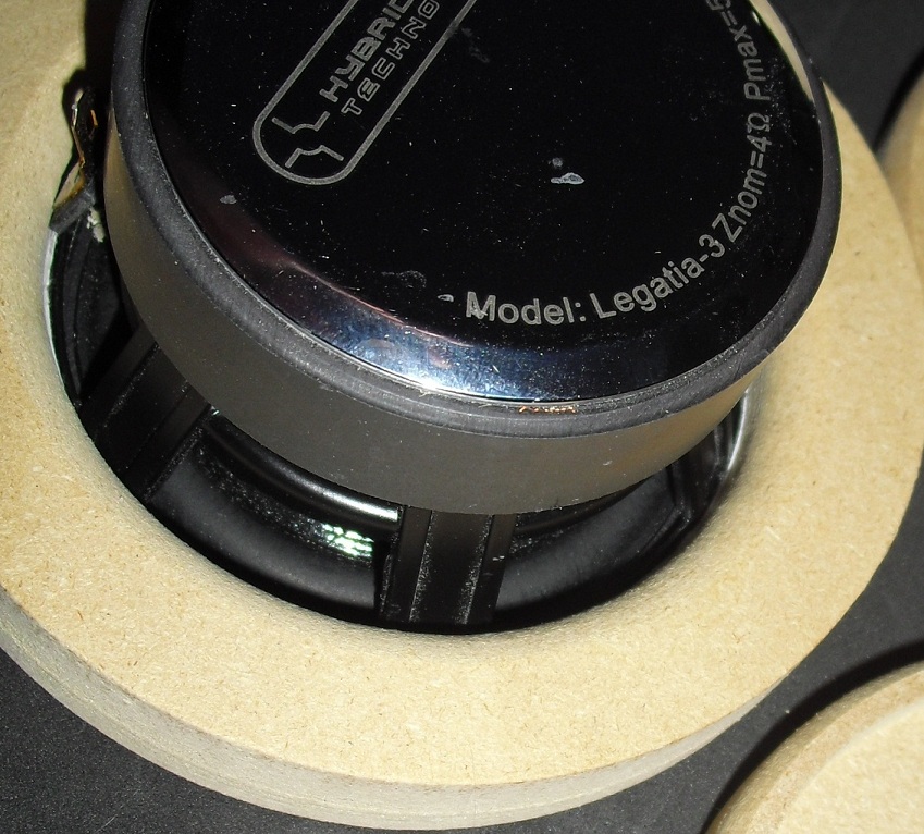

No sir they are not the Vifa's. They are SB Acoustics, these to be exact http://www.madisoundspeakerstore.com...weeter-4-ohms/ .
I am not sure what you mean by the mounts. I am thinking you mean the rings that I glassed into the pillars. I made the speaker rings myself from some scrap mdf I had. They were scraps that were actually the inside cutouts from my 8" speaker rings I made earlier.

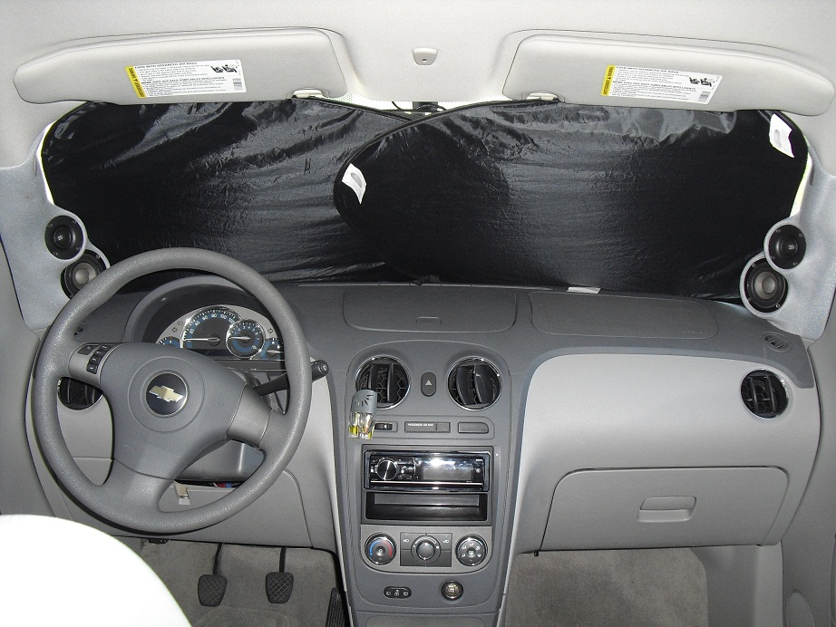

These next two show the contors the best.

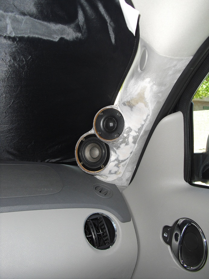

And this is before wrapping. Note I did a final sand and bondo app before wrapping. I have finally found a vinyl that is a match to the lt grey part of my interior. I will be wrapping them in that on Monday.

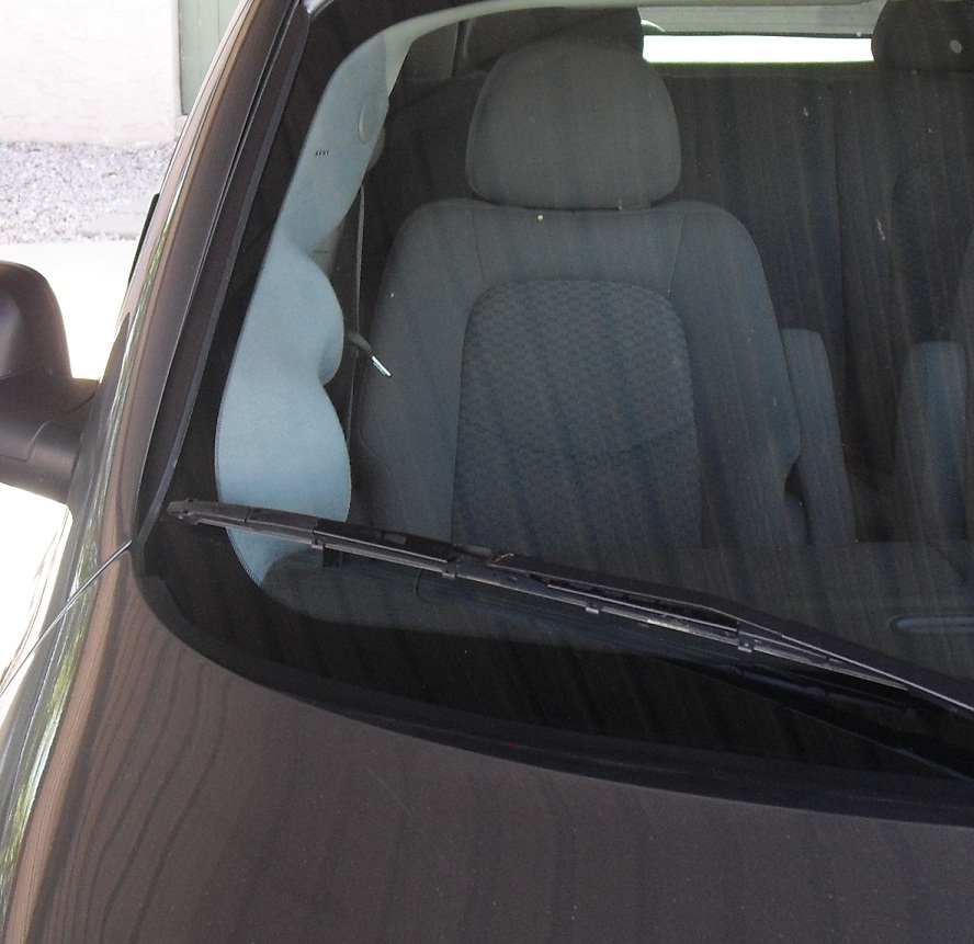

And how about one more for good measure LOL.
