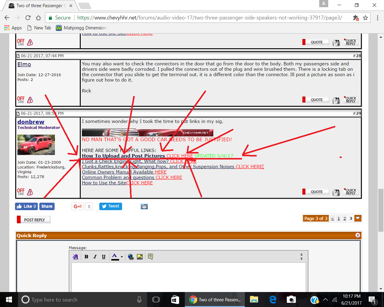

You may also want to check the connectors in the door that go from the door to the body. Both my passengers side and drivers side were badly corroded. I pulled the connectors out of the plug and wire brushed them. There is a locking tab on the connector that you slide to get the terminal out. it is a different color than the connector.
Thanks Don for the link on posting pictures.
Rick
Rick
