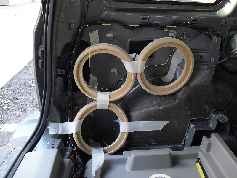

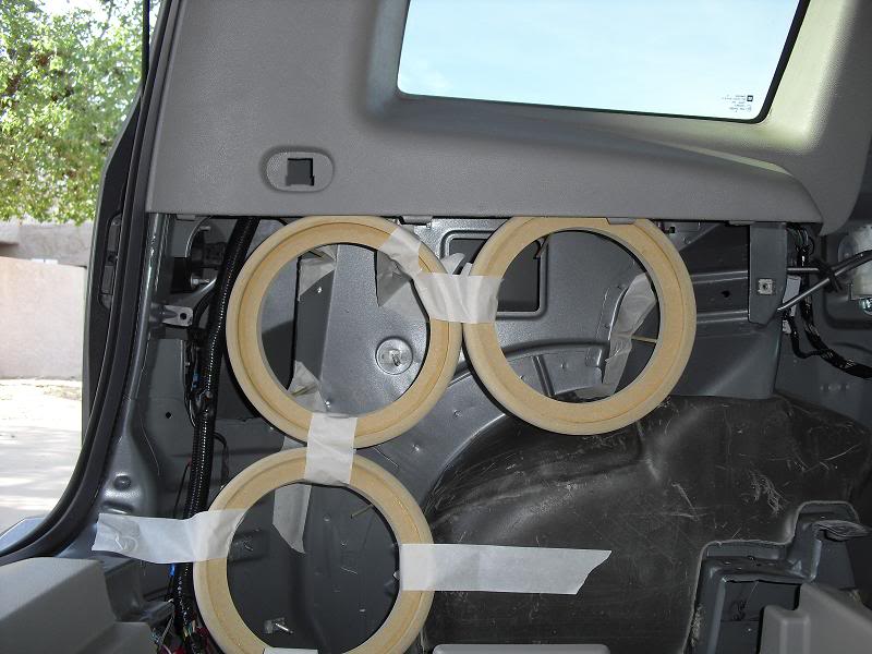

For those that want stealth and to save cargo space this is an option that I am working on for my car. These rings are for 8" Polk MM's. There IS enough space to make the 1.2 cft that I need but without cutting I would have to use every nook and cranny of space to get there. So in the second pic I have outlined where I intent to cut out metal. There is 4" of extra space near the window and even more depth below as the body bows out towards the mid height of the car. I can get a minimum of .25cft extra this way. I MAY choose to use only two subs but three can fit even without cutting.

Awesome Idea 07! If it works out post pics of it done. Todd (Uma)

I will do that. I will be cutting on either Sunday or Monday. By wed I hope to have atleast the behind the metal section built so that I can see exactly how much extra space I have to work with.
