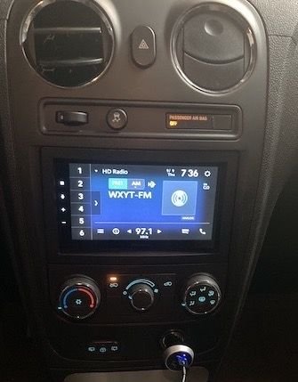

As you can see, with a double DIN radio, the radio pretty much takes up most of the opening with only the trim bezel showing. Even if you don't want a touch screen, there are double din radios with a big ole' volume knob in the center, just like the stock radio. I'm a Pioneer fan so here's a short chassis one I recommend for people who just want an uncomplicated radio - even the colors match the stock radio:

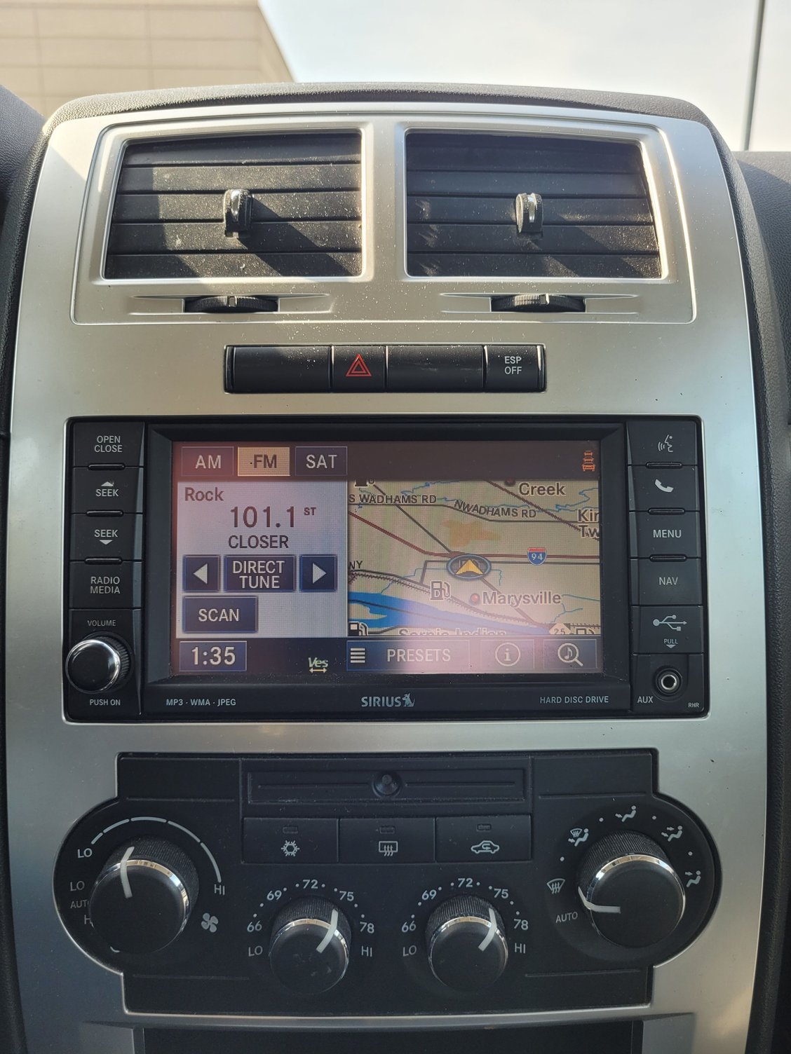

Charger nav radio
Hmm, no fit, need to trim adapter
Meh, could look better

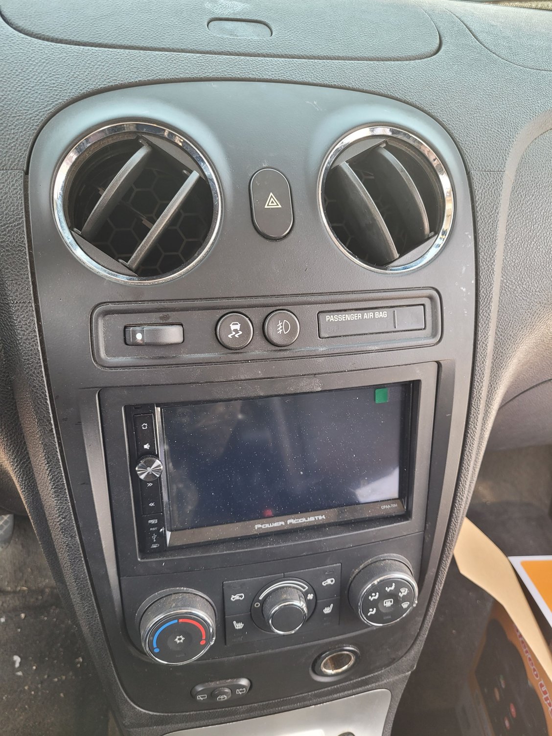

I bought a Power Acoustik head unit, mechless with Android Auto for $67 at Walmart. I stopped paying more for less years ago, as I often upgrade my car audio when new features are available on lower priced units, so I don't really care if they die after a few years (the importance of this will be clear later)
But first, a mini-rant:
The reason I was hoping there was a gm touchscreen that would work is I like plug and play, and factory fit and finish. In short, every thing should work and look like it belongs.
I ordered my dash kit and wiring through Crutchfield, no issues with them at all. Takes all the guesswork out. The issue is that with any adapter, there is a compromise. I spent about an hour mating the adapter harness to the stereo harness, all solder and shrink tube. Mount the radio in the dash kit, well it 'fits', but because there is a slight curve to the dash the radio looks sunk in a bit instead of flush. Might have to rework this or maybe 3D print something. That's a future me problem.
When I put a newer factory navigation radio in my Charger, all i needed was the GPS antenna. I got a lockpick module to add a backup camera and that was it. It looks stock because it is stock.
Rant over
So, I got everything hooked up and the stereo works, OnStar works, subwoofer works, time to plug in the steering wheel control and map the keys. Here's where it starts going bad. The controller recognizes the steering wheel buttons,but not the radio. Try the troubleshooting tips, no good. pressing Volume up activates OnStar. That turns the radio off. Not good, volume up is supposed to start the radio programming sequence for the buttons. Reset and try again. Now volume down activates OnStar, lol.
it's getting late, I decide to deal with SWC later and just put it in the dash because i need to go to work. After much agony and gnashing of teeth, its in the dash. Now, the radio powers up, plays at low volume and nothing is responsive on the radio, so I call it a day and drive the Charger to work. I shall mess with it tomorrow.
I have installed hundreds of car audio systems, am an electrician by trade, and do PLC programming anf robotics at work. I write Arduino code for fun. This isnt an issue of not understanding the work, its an issue of knowing it could be better.
But in the end, this is why i prefer to go with factory parts, they just work. All this because I want Android auto in my car and a backup camera without hanging geegaws on my dash.
