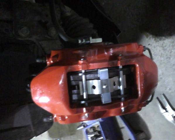

Added brembo brakes to the front of my 2010LT and I am still using the stock 16" wheels with 1 1/4 wheel spacer. I bought the caliber's used and rebuilt them. I ordered the rest of the parts from rock auto. The wheel spaces was off of ebay. Parts that you will need . 2 brembo calibers, set of brembo pads , 2 each front rotors ( I bought drilled and grooved) Set of pad pins. The pins that came with pads were to short so ordered new set pins only. 2 new hose to go from caliber to hard line (LT are to short by 2"). New crush washers 4 each. You can reuse the banjo bolts off the LT calibers.

Which rotors did you use the one in the picture looks like the non Brembo SS 11.65 inch the Brembo rotors are 12.4 inch diameter , it just looks a little small in that Brembo caliper

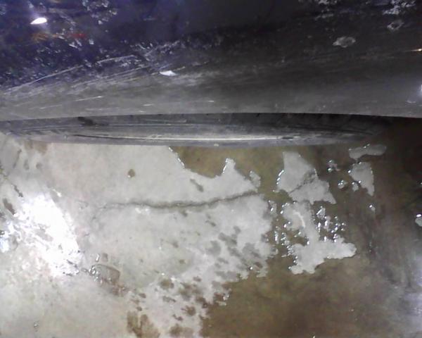

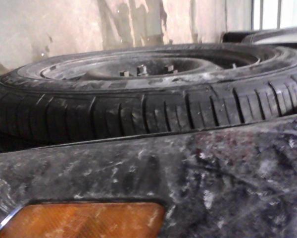

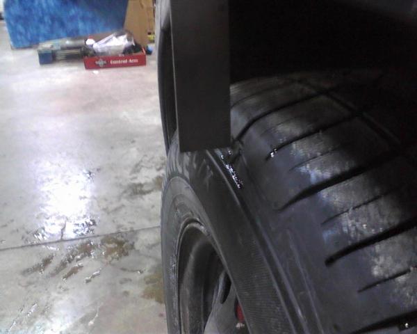

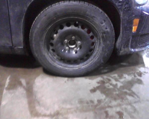

Oldblue the rotors are 12.4 and here is the pic of the wheels on the car. In the first pic the scale ruler is against the fender. in the sec one it looking down on the tire from above . 3rd pic hole wheel on car and in the last pic is looking down the side of the car from front bumper. Hopes this help any one thinking of doing it to a lt also.
