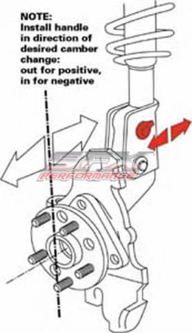

Being that you are in the heart of "pothole territory", you might just get it aligned as an annual thing since it doesn't take too much to tweak it out of spec.
The camber on that corner is out of spec by the description you've given, if its as I suspect the alignment shop can install a camber adjustment kit on that side to bring it back to where it should be.
You can have a vehicle with the camber setting knocked out into the "goofy" range without being able to feel it on the highway, you'll feel it more when the toe is out of spec....then it'll pull.
Old Aug 14, 2011 | 11:37 PM
fyi: camber kit (if needed)....
Old Aug 15, 2011 | 12:30 AM
Yeah that's the gadget sleeper, its a guess as to whether tntwolt's camber is out of spec on that corner due to the world famous PA potholes, or whether its been that way since his HHR left the factory.

Very true, + well worth having an alignment done to know the score, reguardless..
