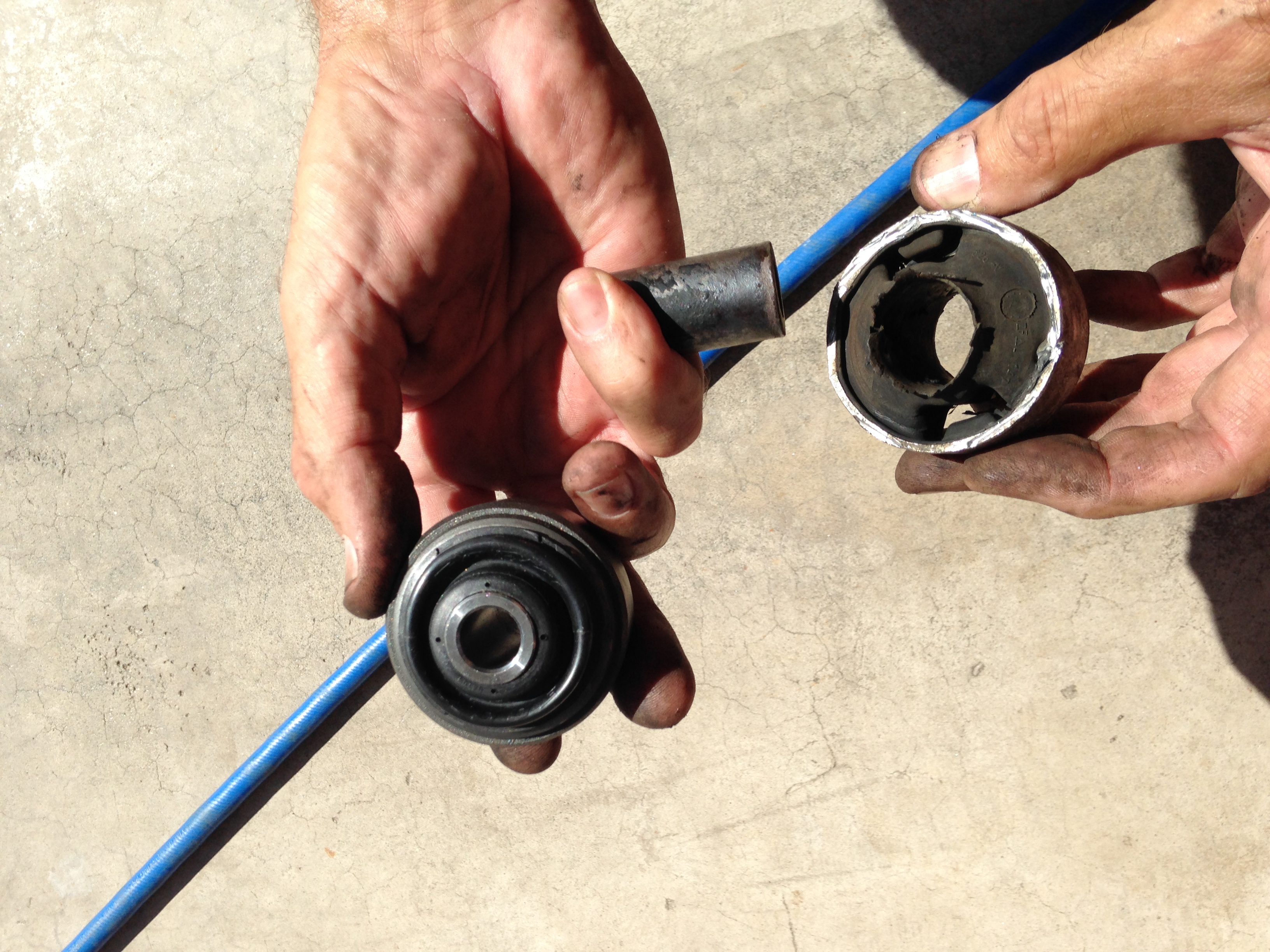

I'll look at that also. I have a machinist backround and still have equipment at my disposal. Arbor presses and machine tools. Dad has a shop in his basement.
My first MOOG bushing is on the right, the Moog K200792 bushing / bearing is on the left , worth the effort to tighten up the front suspension!
The rubber bushings are inexpensive, but you get what you pay for! I found Summit Racing has the K200792 bushing
