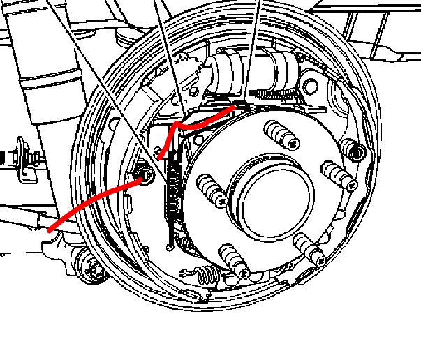

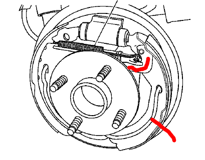

My 2008 had the horseshoe spring the 2011 had the American type . The self adjuster worked opposite each other.
Horseshoe Name:  horse.PNG

AmericanName:  amer.PNG

I think you might have put them on wrong. Maybe the self adjusters were wrong.
Which type of brakes do you have? The top pic or the bottom.

I have the top pic. I did not put them in, a local shop did the work. I needed to replace the wheel cylinder on one side, so I had them replace the entire guts of both sides for piece of mind. Since each side spins opposie the way it should, I think they are just backwards. Now I do not know if I should go back and ask them to swap the two sides, they may refuse or think I am crazy, how can I prove that they are spinning opposite the way they should without coming across as a whiny young know it all? I didnt notice until now because I hadnt tried adjustment till I posted in this thread.
