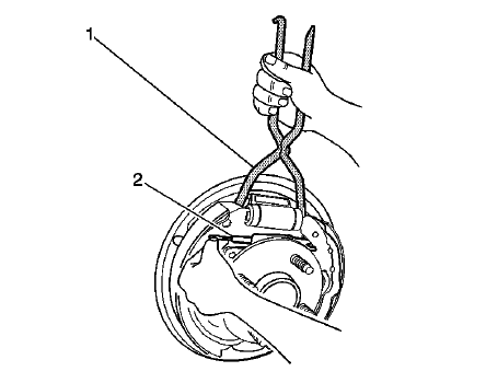

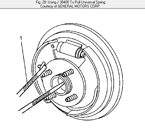

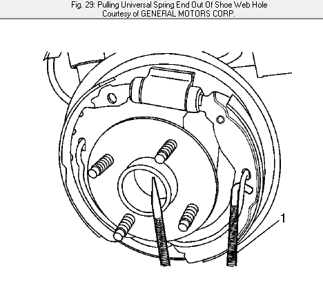

It is not all that easy especially without the tool. The tool is cheap. I will bet $.25 the mechanic does not have one.
Size:  3.4 KBName:  webhole.PNG
Size:  21.6 KBName:  adjuster.PNG

But, in all seriousness, the adjuster is removable on its own without taking the shoes off right?
Old Apr 9, 2017 | 04:31 PM
  #45
Posts: 26,536
Yes, with the tool. I am guessing that the lever is on wrong, possibly the wrong parts.
