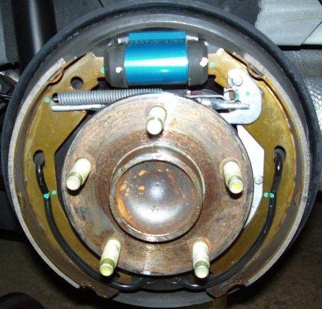

Old Apr 21, 2012 | 10:26 PM
swerv0428- This is what the rear brakes look like with Drum off..
This is driver side view, adjuster is always to the rear on both sides..
As you will find, the backing plates should have rubber plugs, that you remove to adjust w/drums on..
But would be a Great time to pull one drum at a time, & get the brake dust out & inspect brake shoe lining, etc.
Don't use compressed air to clean..(Avoid breathing any Brake dust)..
You could use Brake Kleen, or even water in a spray bottle..

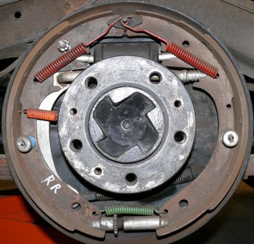

And here's a rear brake on my 75 year old Suburban Carryall, not much difference is there, I bet a mechanic from 1937 could handle HHR brakes....the engines and computers would seem like Flash Gordon stuff though.
