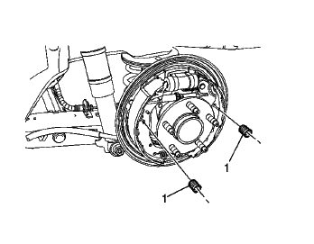

My driveway is 100 ft. long on a pretty good grade. I always made a point to slam on the brakes 2 times on my way out in the morning. I had to do at least 1 click every oil change to keep them adjusted.
If the self adjusters were doing anything it was not enough. This was on a 2008 and a 2011, they have different set ups. The 2006-2009 have European style universal spring and the 2009-2011 have the more American spring on a post hold downs. They changed over sometime in 2009, some 2009 models have the 2010 style.
2006 -2009, this is the way to remove them
2010-2011
