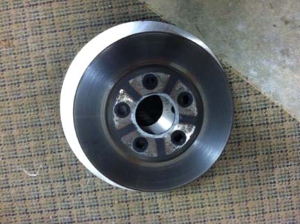

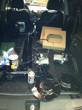

Here is the size difference between the 2 rotors.

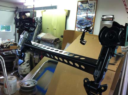

I just bought a Cobalt SS rear axle off of a guy on the Cobalt SS website. Very reasonable. I am having it sandblasted and installing new hoses, rotors and pads. I also bought new parking brake cables. ABS is the same wiring on the 2005 Cobalt SS and I am reusing my rear hubs.

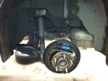

rear disc
parking brake cable
bolt holding the rear axle beam
sorry if pics are bad, not the best photographer

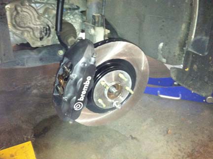

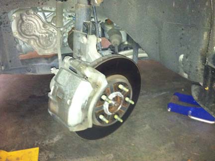

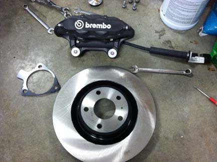

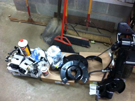

Well.....I finally did my brake upgrades. Same as Pbatmen. Brembos up front and Cobalt SS rear axle. I tried to remember to take lots of pictures, but probably not as many as I should have.
The front was ridiculously simple. Unbolt the old caliper and set aside with hose attached. slip off rotor and replace with Brembo rotor. Install Brembo caliper with two bolts mounted to old caliper bracket mount position and remove and install brake hose(I used brand new GM ones and they came with the brackets and retainer bolt with copper washers. I did not use the spacers that are shown. They SS steering knuckle and hub and bearing assembly must be slightly larger than the 2LT one. I then gravity bled the system and the job was done. Then I started the rear.

Now for the rear.
I purchased the rear axle from a guy on the Cobalt SS site. He is also the same guy that I purchased the Brembo calipers and rotors from. He may have more available if anyone is interested. Mongorat is his call name. He is very reasonable with pricing and has quite a following. I also bought my supercharger package from him.
