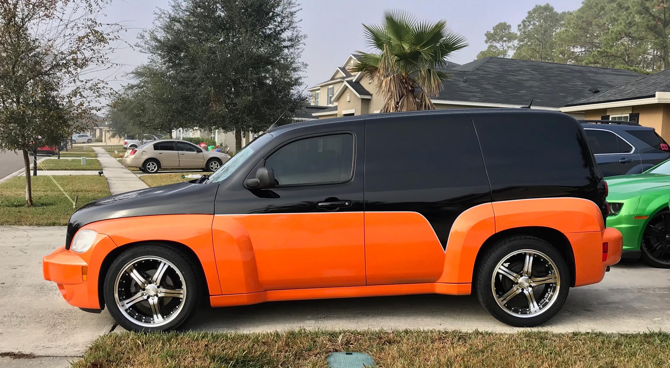

Hey guys! Im new here, but this is the second HHR Panel Wagon ive owned. I recently purchased it to advertise our hobby shop. So we got it painted, got it new shoes and decided to lower it like my old HHR. On my previous car i had installed Eibach springs but i wanted something lower this time and after doing a little research, i saw some people recommending Canuk Motorsport springs. So i ordered them and installed them about a month ago and was a little disappointed with the drop but i figured it might settle lower in the next few weeks. Well, it never did. It sits just like a stock set up. Like i never replaced the springs at all. I tried contacting them but they havent responded. So can anyone tell me who makes a spring set with a nice low drop? Was i right the first time with Eibach? Im trying to include pics, but im not sure if its working.

Send Ray at Canuck an email, your rear springs should be a full 2 inches lower than the stock springs.
I’ve run Canucks for 175,000 miles and had no issues!

Thanks for the feedback guys. I'll put it to good use. In the meantime, i just got an email back from Canuk. Theyre gonna call me in the morning. I hope they can shed some light on this. I just want that rear end to come down! lol

For me, Ray sent out new rear springs at no charge. Remind them the listing on their website shows 2 inch rear drop.
